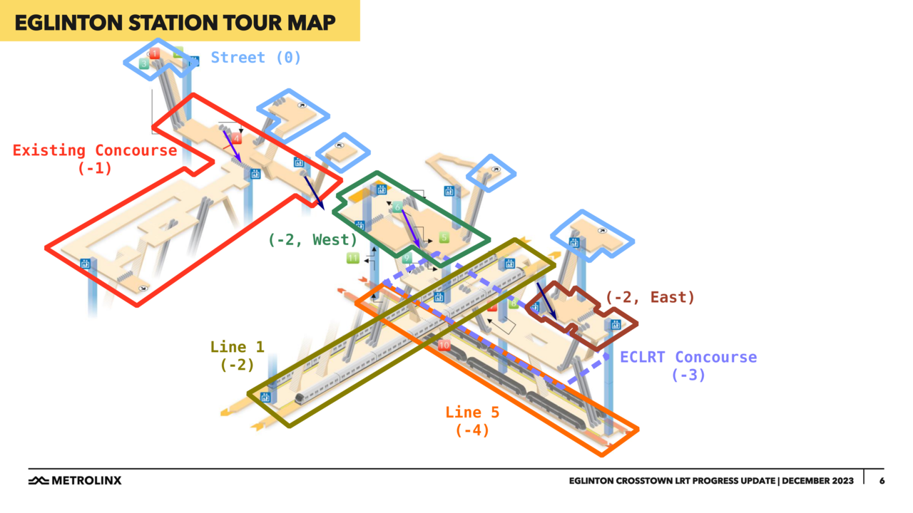

eglinton-separate-sub2-png.528053
Are those fare gates in the final locations? If so it looks like there is only one connection between Line 1 and 5 that doesnt require passengers to leave a fare zone and then re-enter...
Probably, it aligns with plans approved at a 2018 TTC board meeting. And right on the fare-paid transfer, there's only the connections at the centre of the ECLRT concourse (stairs to the north, escalator to the south, elevator in between).
