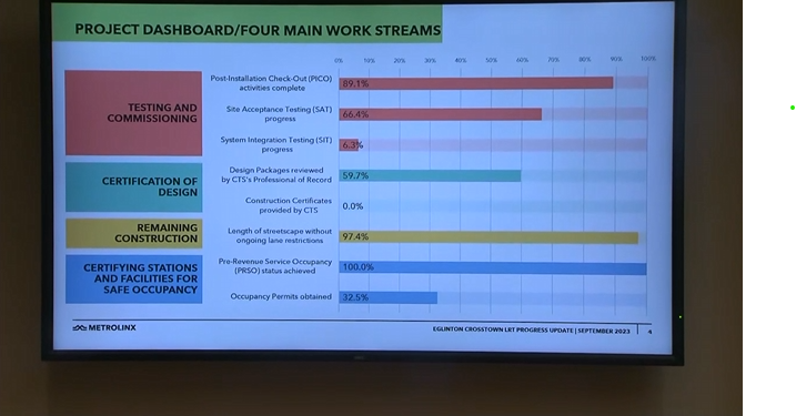

Summarizing:
  • Verster:
    • They now have an internal schedule for all project elements, but will not announce a date as a result of recurring issues encountered during testing & commissioning
    • Commit to progress updates every two months
  • Technical update given on testing & commissioning problems thus far:
    • Issues with signaling requiring software updates, which require tests of their own
    • Widely discussed track issues
    • Groundwater penetration of stations and tunnels
    • Sloane stop repairs
    • Generally vague, but clear that process is not near completion
  • Remaining construction:
    • 400m of surface remaining to complete
    • Yonge and Eglinton is primary focus of remaining construction (watermains, road resurfacing)
    • "The stations look to be complete" barring testing and commissioning
  • Station occupancy permits:
    • Received for most surface stops
  • Other minor updates
  • Q&A:
    • Verster refuses to give a date due to lack of progress (mentions fleet and signaling issues), commits to giving a date upon completion of testing & commissioning phase and updates every two months (including quantitative updates on testing & commissioning)
    • Recent ruling that CTS litigation in May will be addressed through arbitration
    • Re-emphasizes that Metrolinx has an approximate date internally, but defects/issues mean lack of confidence in any date given to the public
      • Presumably this is an indication that "no credible plan" is no longer the Metrolinx position.
    • Couple of confrontational questions, Verster responds that he's accountable to Ministry and that new bimonthly presentations are a step up in transparency
    • Total budget (previously reported): $12 billion, currently at $12.56 billion
    • On Finch: Significant progress made, but all projects have been impacted by COVID (touts progress on various other projects)
    • "We're not that far away" on ECT, but ML must be confident on date before announcing
    • Testing & commissioning dashboard will be updated every two months, but not in real-time
    • ML and collaborators are committed to delivering projects as soon as possible
    • 1400 defects and deficiencies have been addressed, but new ones are discovered over time (general error, technical issues, miscommunications).
    • ML must be meticulous in "getting it right"
    • Do not draw conclusions from "every two months" (i.e. extrapolating out to much longer delay)
    • Commits that ECT will open "flawlessly" (EDIT: journalist asked whether Verster would stake his reputation upon it, Verster responds affirmatively)
    • Groundwater issues specifically mentioned at Keelesdale
