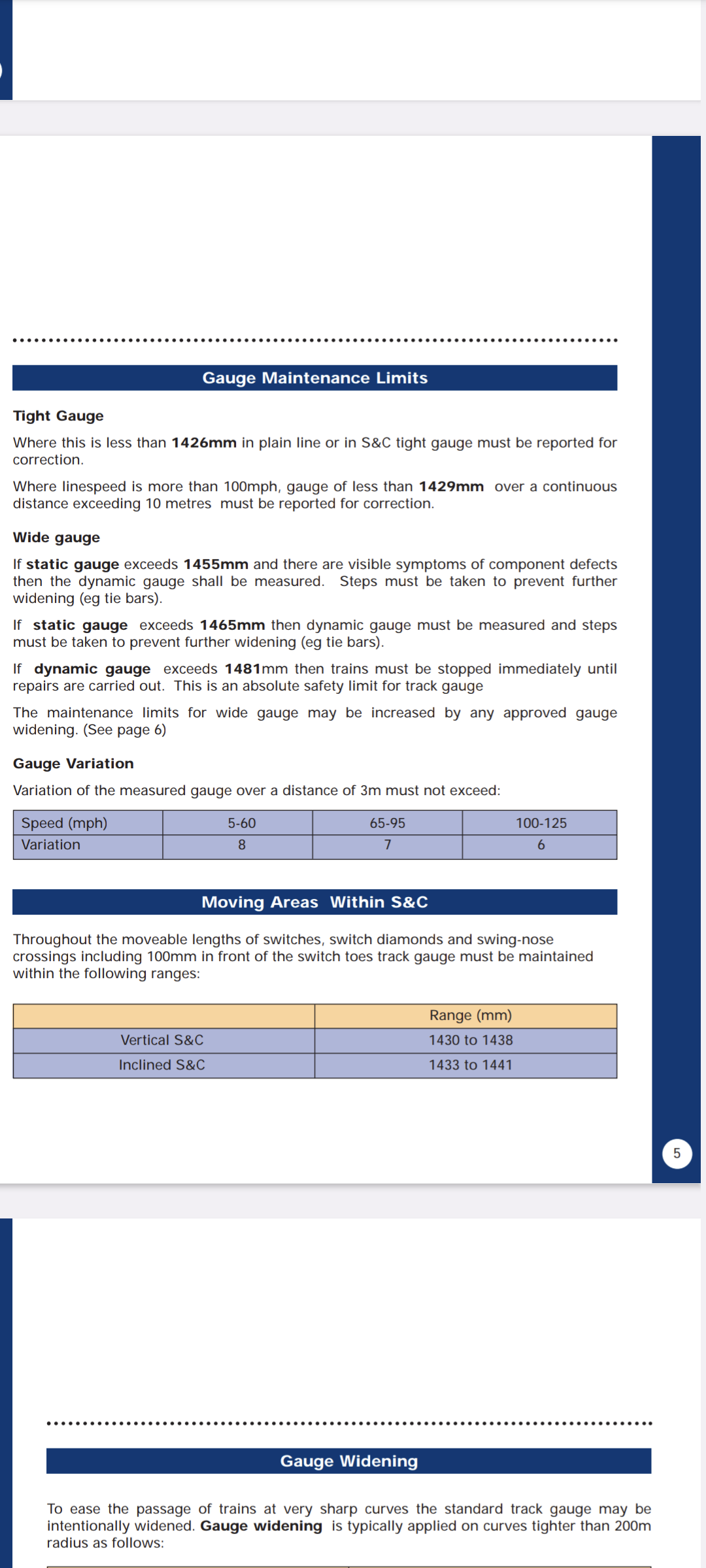

Here is some information about the tolerances within the gauge. It says only when it exceeds 100mph does it matter within 3mm. However that's based on the track originally being up to spec. Which in this situation it's not. I wonder if they could change the angle of the rail to bring the heads closer or apart by 3mm to bring it within spec?
Exactly... at Tram speeds I honestly don't think it would matter. It's only for hsr where it would be very noticeable.

It will be if the track exceeds that threshold for whatever reason, which could cause a derailment. Would you accept a new car that had miss-algned wheels and the dealer says it's fine dont worry about it?
I think whether it will be a problem or not it will depend on the design of the vehicle's wheel treads.
It's not unheard of for track to be laid slightly out of gauge, though I'd assume it's rare in a rapid transit system, since they usually have a more standardized approach to doing things. The example I know of occurred on a narrow gauge railway in Wales in 1951:
Upon arriving Sir Haydn was the engine in better condition but frequently derailed however and could not be used safely. Upon inspection it turned out that the Talyllyn track was laid approximately 0.5 inches (13 mm) wider than the official gauge, a deliberate policy by the old company to accommodate the long wheelbase of Talyllyn. The two original Talyllyn locomotives had unusually wide wheel treads that allowed them to stay on the wide-of-gauge track. This problem was eventually cured by the fitting of wider wheel treads and by a Territorial Army members' exercise in 1953 relaying the railway to its correct gauge making Sir Haydn usable.
However, I am no expert on the wheel design of the Flexity and whether they have sufficiently wide wheel treads for this to not be a concern.

Steve Munro has a comment on this yesterday, and he notes he's not completely certain, but it was "I believe that the problem has been misrepresented as one of gauge when the real issue is the rail profile which does not match the wheels on the new cars. This is similar to a problem with track in Ottawa, and the fix involves grinding the railhead to change the profile, not relaying all of the track."
