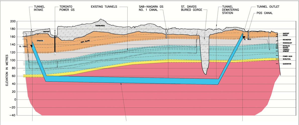

IIRC they hit surprise pockets of softer shale, which tended to bring down the ceiling of the excavation beyond what harder rock would have done.
With the TBM? It's almost all in various sublayers of the Queenstown shale - one would expect softer shales. Some of it is almost more like silt than rock, particularly at the boundary with the lower Silurian.
I hadn't realised it was so deep. I haven't been following it closely - I'd have though they would have been higher, to stay out of the Queenston.
Is this a cross section of a tunnel near Niagara Falls? What's the relation to the Crosstown's underground environment?
