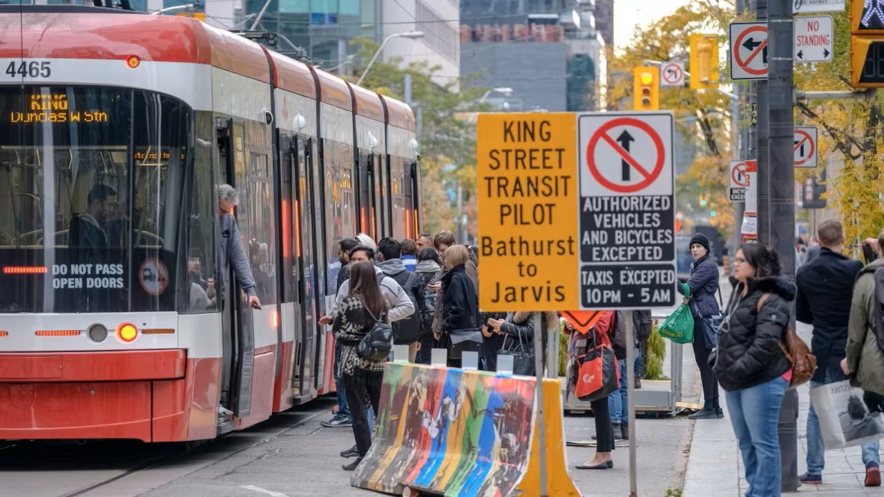

I had a couple coworkers venting about the excess number of stops on the streetcar routes and how you can basically walk and keep up with the King streetcar (is that still true with the changes they did on King?)
Generally speaking, you can't quite keep up with the King streetcar if you're on foot. It is still slightly faster than walking, though a whole lot slower than biking. Once you get out of the downtown core, it's quite a bit faster than walking, though usually still slower than biking.
A big part of the problem is that it has to stop at almost every intersection because in many cases the driver has to stop the car before going through the intersection, even though the light is green (and then the light changes while it's stopped).
Yep, still one of the slowest, if the the slowest streetcars on the entire planet. Not to worry though, Chow shoveled some millions into hiring a hundred traffic agents that never seem to show up to work.
