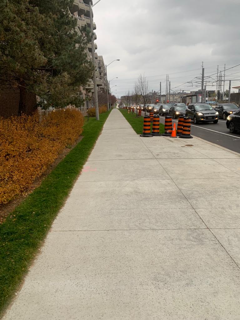

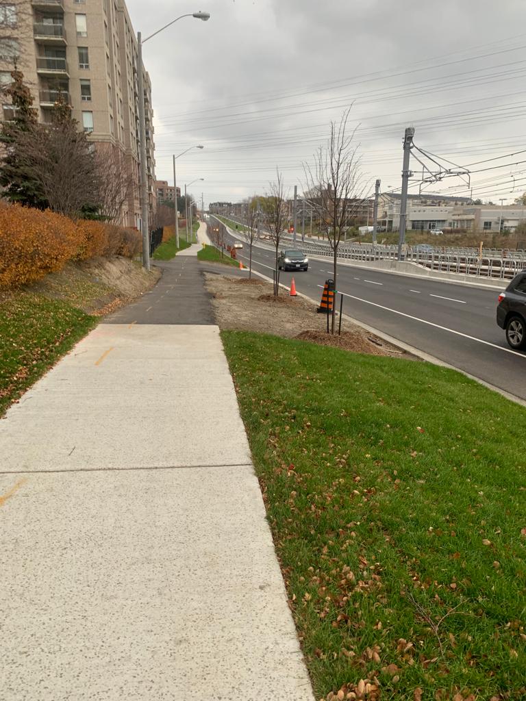

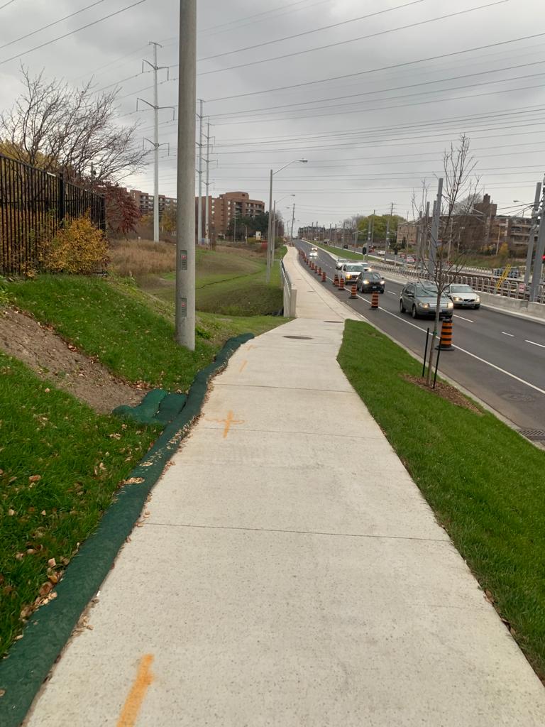

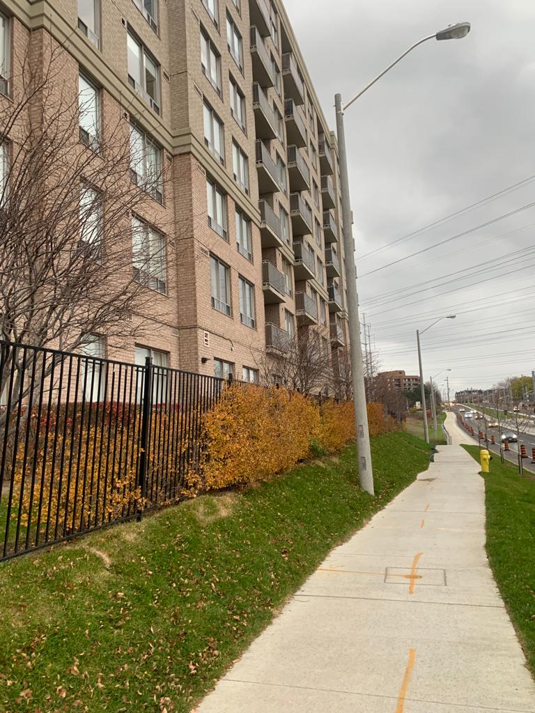

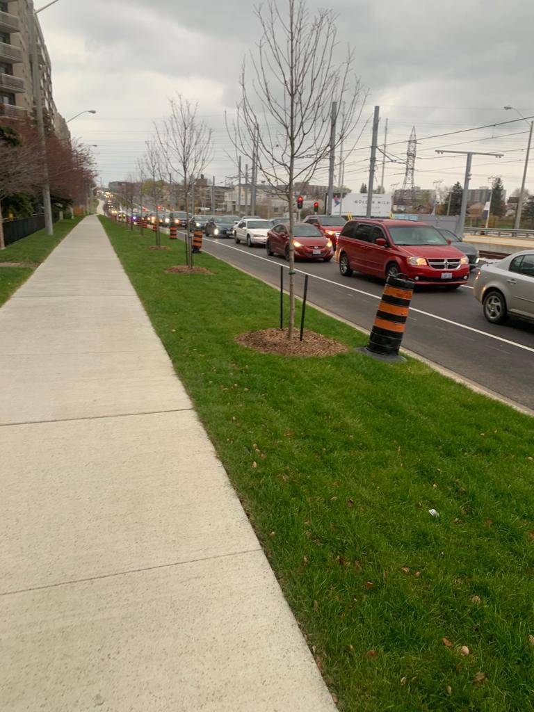

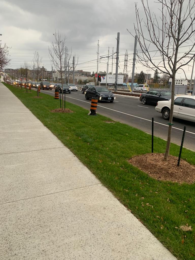

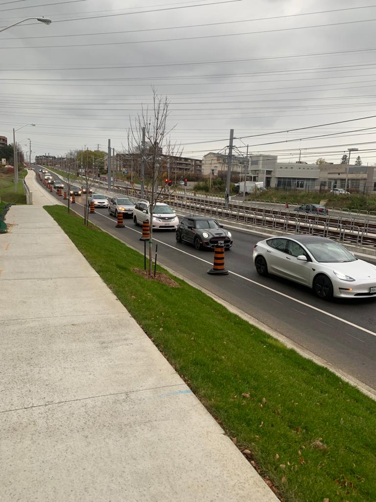

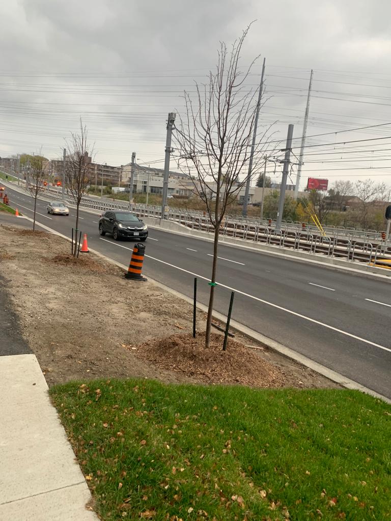

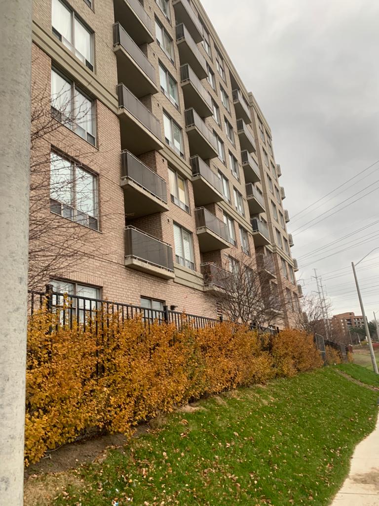

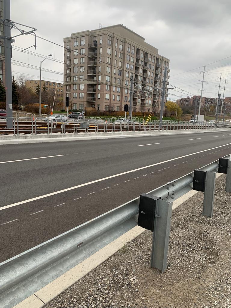

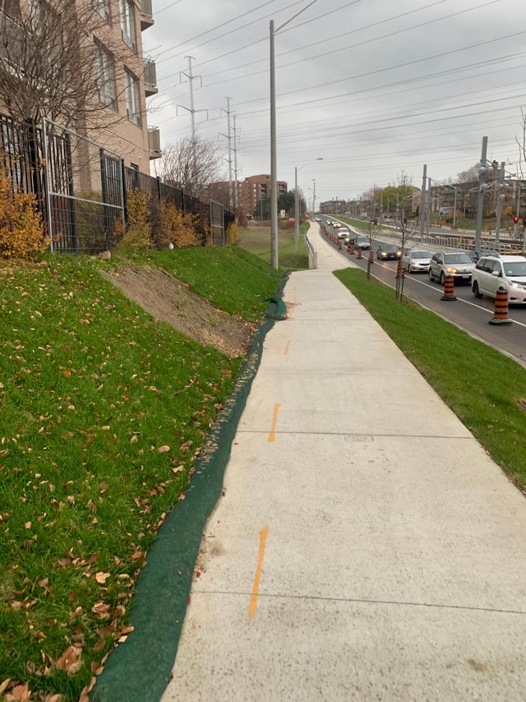

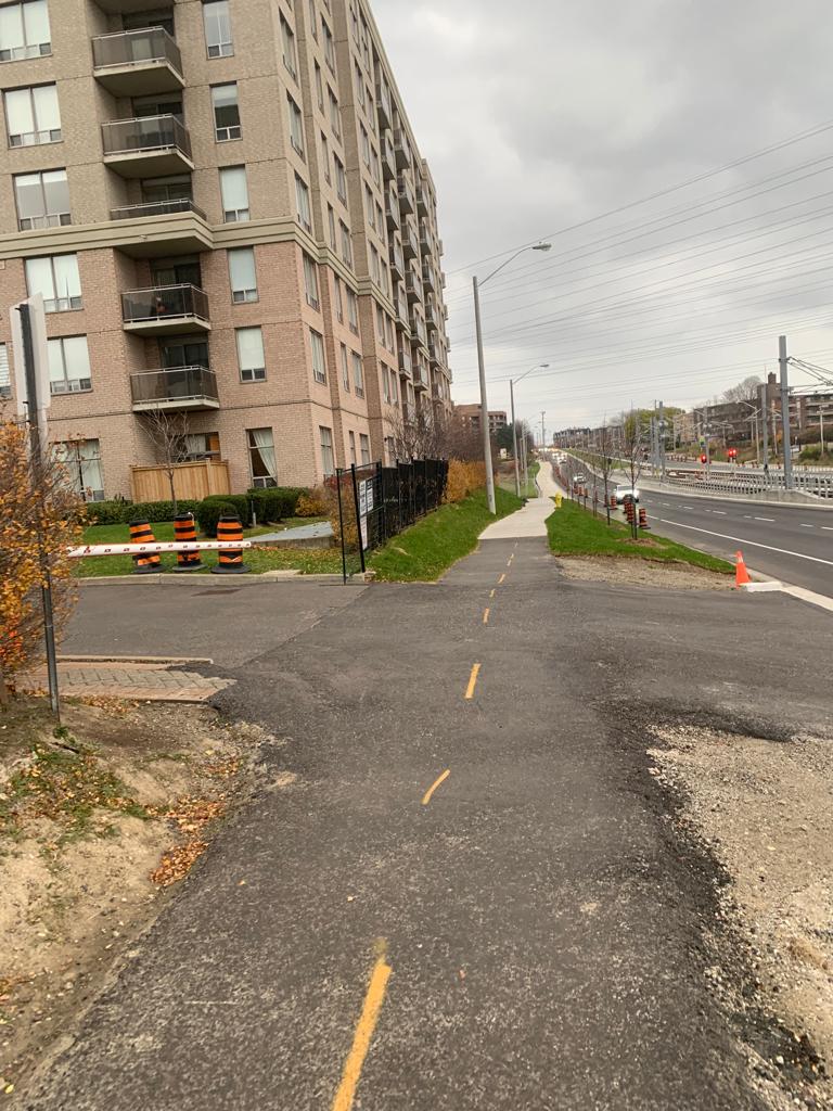

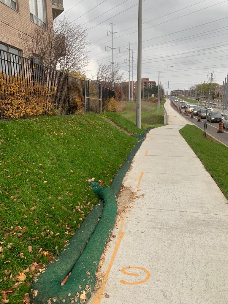

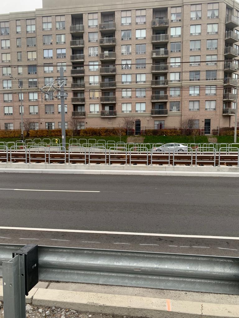

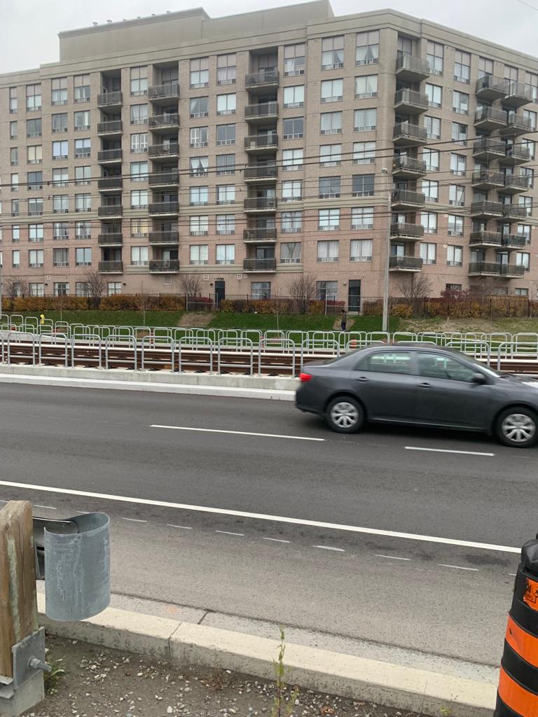

Crosstown LRT Updated Pictures between Eglinton and Sloane/Bermondsey and Eglinton and Jonesville (just west of Victoria Park). I assume Metrolinx will want to get as much work done as possible before the snow starts coming down hard in the next 3-4 weeks. Pictures from November 21 afternoon.
