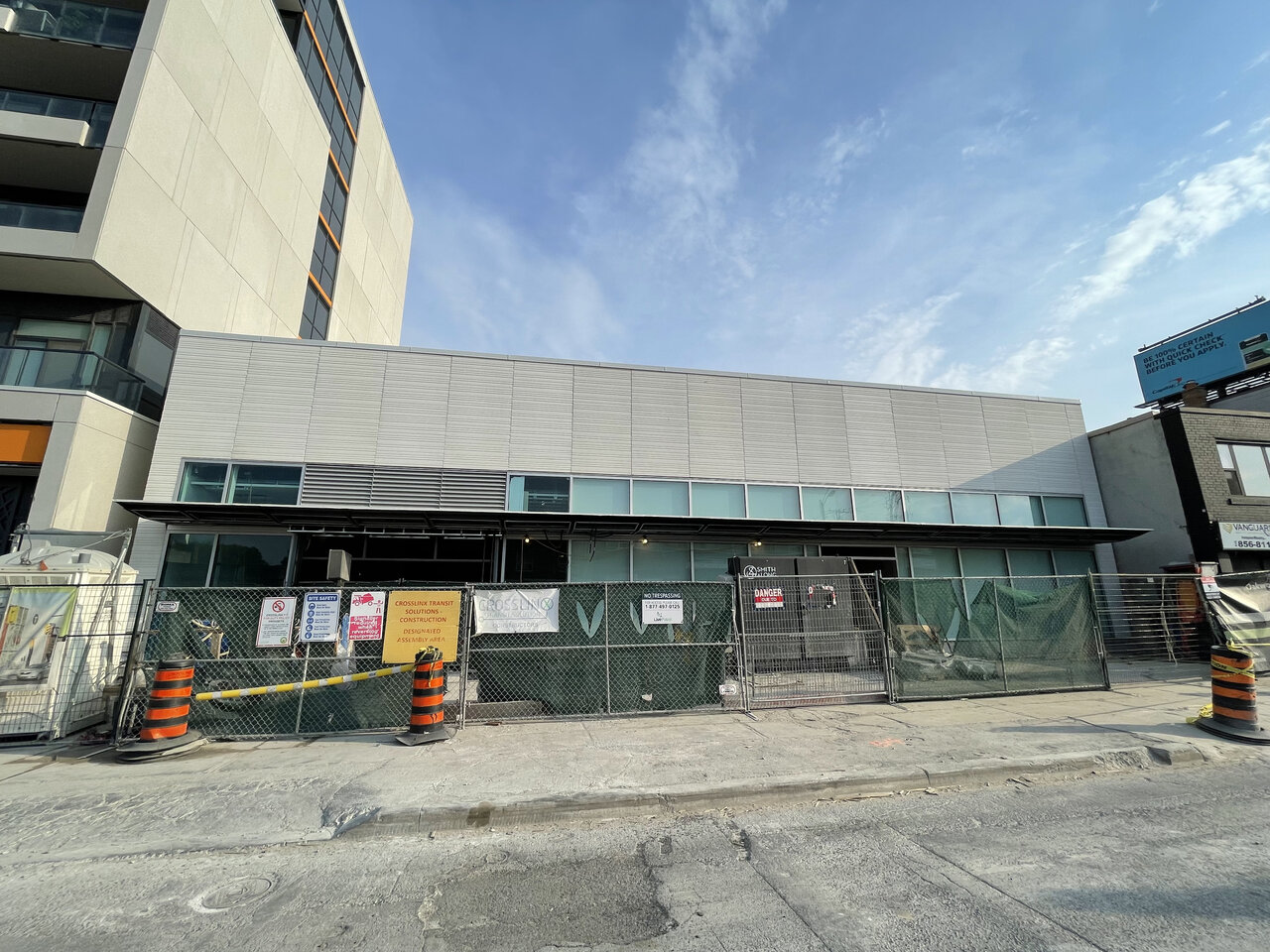

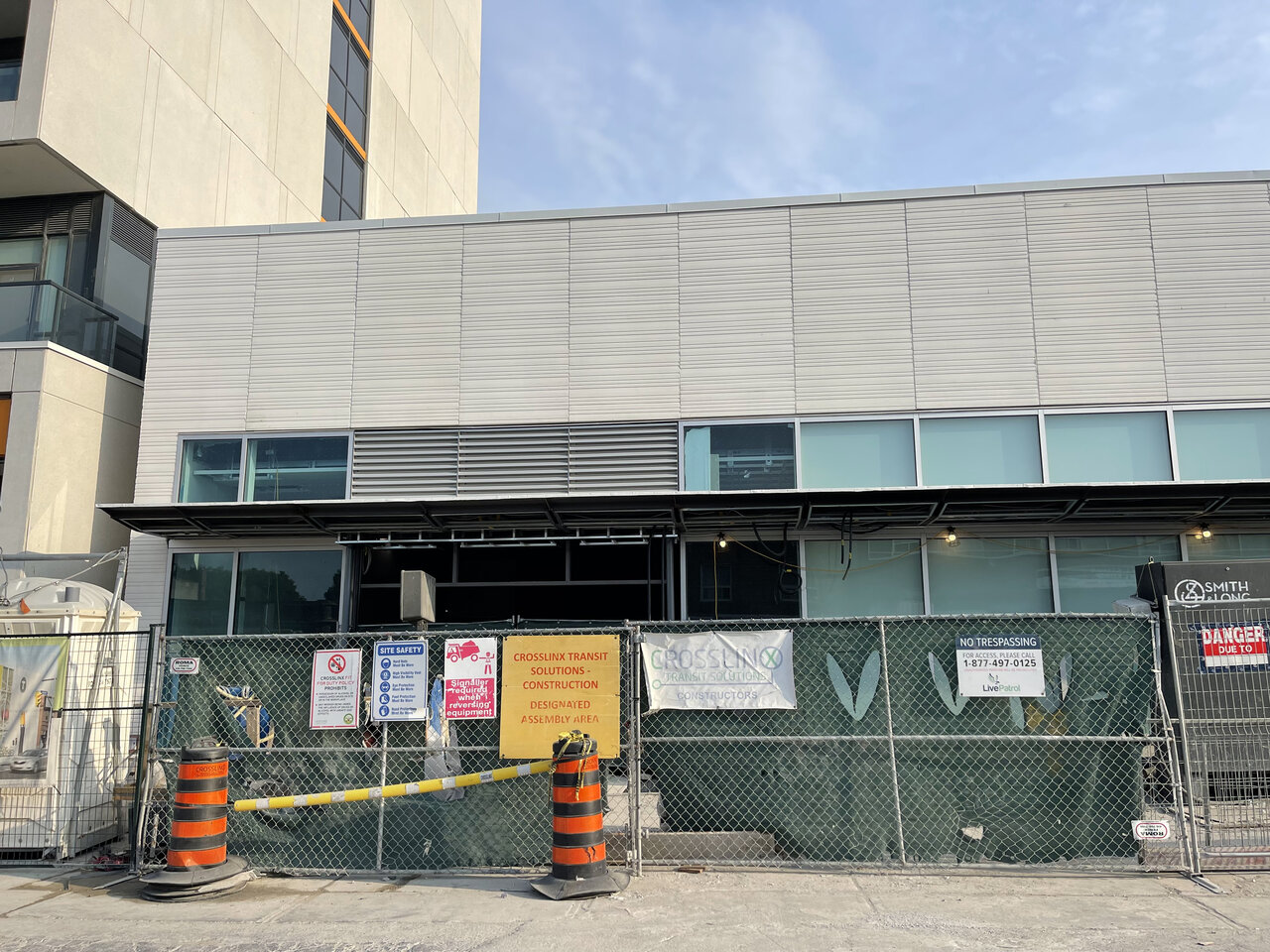

Secondary entrance:

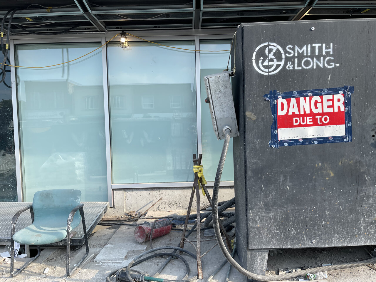

Why would a regular chair be on an active construction site?
