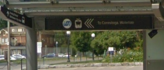

This is a really minor detail, but I really hate how none of the signage matches the rest of the system. Like, why are there arrows on all the stations in the strip maps? Why is the font different? Why are we using chevrons instead of arrows for the direction of the trains? Can ML seriously not make the line fit in with everything that already exists and have some design consistency? It doesn’t even match GO’s maps.
That station design may not match the other station designs of the TTC but it does fit in with the design language of another (partially) provincial funded LRT Line.
It's essentially the new design language being pushed by Metrolinx for Eglinton, Finch, and Hurontario. The boring white and black finishes, the font, the symbols, the diagrams and bilinguality. Personally, it's nice and minimalist, albeit a bit boring.
