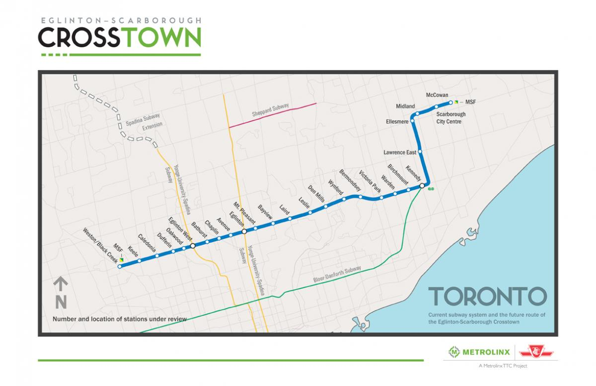

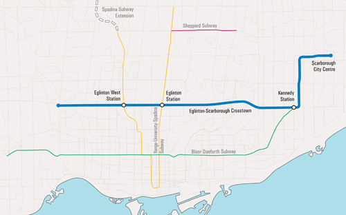

It's disappointing to know that this used to be preferred option until Karen Stintz decided she wanted to be Mayor. Imagine a 100% grade-separated, continuous line from the airport to Malvern (once extended.) Elevate instead of tunneling for Eglinton east/west and you get it for significantly less money than we are spending on SSE + EWLRT + ELRT.
I'm not really sure it was the preferred plan. It certainly was a great political move for Ford, but it removed funding for every other project, including the Finch West LRT.
I also don't think in the long run it would've been beneficial for those on the Eglinton East corridor.
