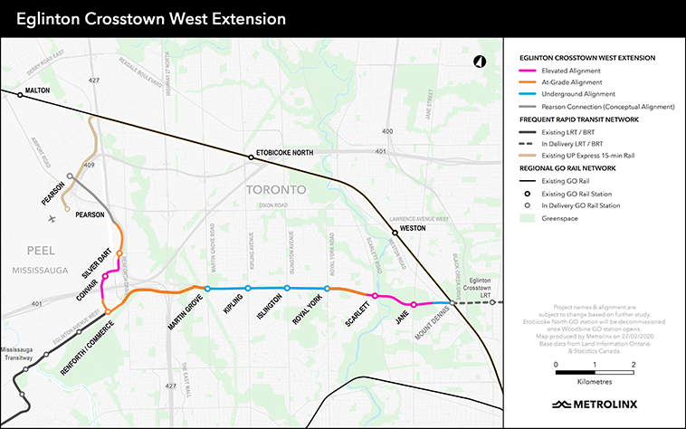

I don't think of royal York as being a major intersection compared to the other three. I would just stay at surface until islington.
Just my 2 cents that I will conceed that there can be some merit to having the line underground between Royal York and Martin Grove. However, having the line buried from Martin Grove to Renforth/Commerce is asinine and a complete waste of money for so many reasons. There is literally no density there and a noodle of highways. At grade/Elevated would more than suffice.
It shouldn't be any more than this.
The key is the Eglinton intersection with the 401 off-ramp.
First, there is a separate study about re configuring this to improve traffic, reduce weaving, etc. This has not been considered.
With the current location of this intersection, it is not possible for the line to elevate east of Mimico Creek, especially on the south side.
- The repercussions of this are to be deep enough to go under Mimico creek, it has to stay underground much for much longer. (You could likley stay north of Eglinton and go over Mimico Creek there, but then the repurcussions are thatyou have to stay north of Eglinton and cross over the entire interchange at/near the highest point, and come back to earth 1.5 to 2.0km later vs. <500m if you went under the end spans of all the Eglinton bridges.
Why not just keep the whole thing at the surface with duck-unders/overs at Islington, Kipling and Matrin Grove. Tunneling seems rather extreme if all we’re trying to do is avoid congestion at three intersections

If we assume that coming westwards the line will be below grade with an underground station at Martin Grove, is it fair to say that the only impact will be to the west of that?
I can understand if the location of roads, gas lines, etc forces some tunnelling at this point. It's a more technical challenge than east of Martin Grove, a bit of threading the needle. The goal would be to get the line back to grade as quickly as these impediments allow, well east of Renforth.
So what? the trains will be manned anyway, and it will be a TTC operated line. Hardly worth the expense of a full tunnel.
