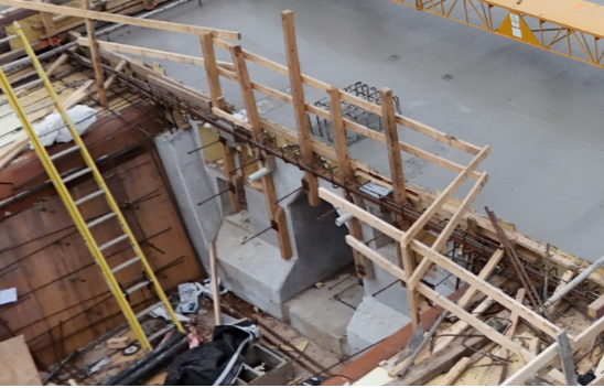

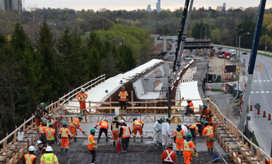

I think you guys are talking about the walk-through opening at the pier.
There is actually a trapezoid shaped void through the entire bridge. It is the inner formwork of the webs (white-ish colour in the middle). At the piers, where the reaction force is applied to the main girders, they need a solid section to carry this big, concentrated force from the pier below. They eek out a small opening through here so an inspector can walk the length of the bridge through the middle. Depending on the bridge segment length and curvature, they may similar solid pieces within the span as well (this looks like a curved segment and has at least one - also with passage for inspector to go through).
