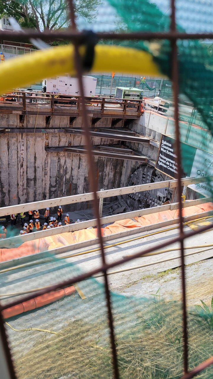

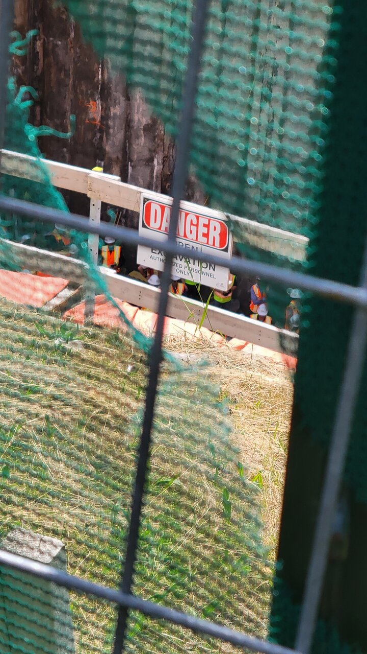

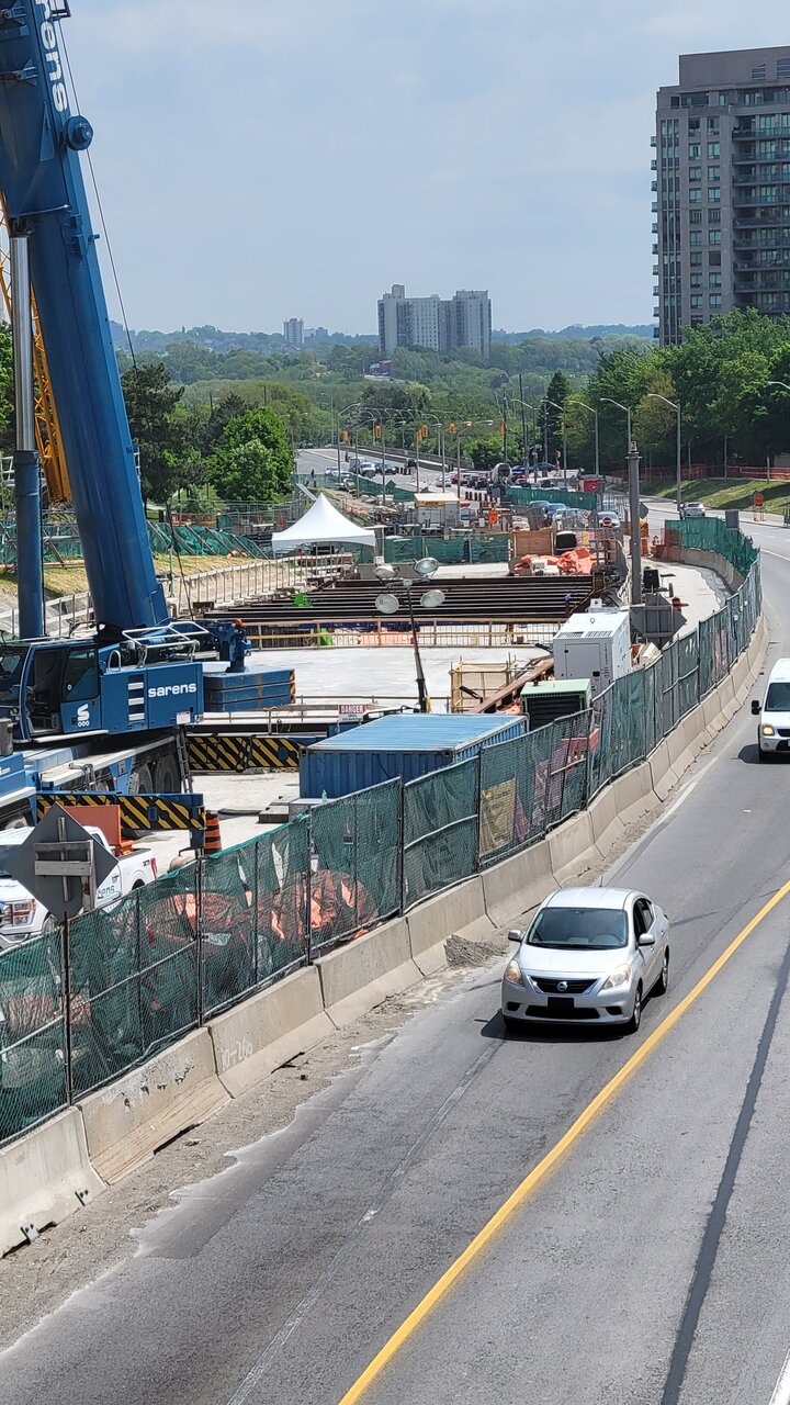

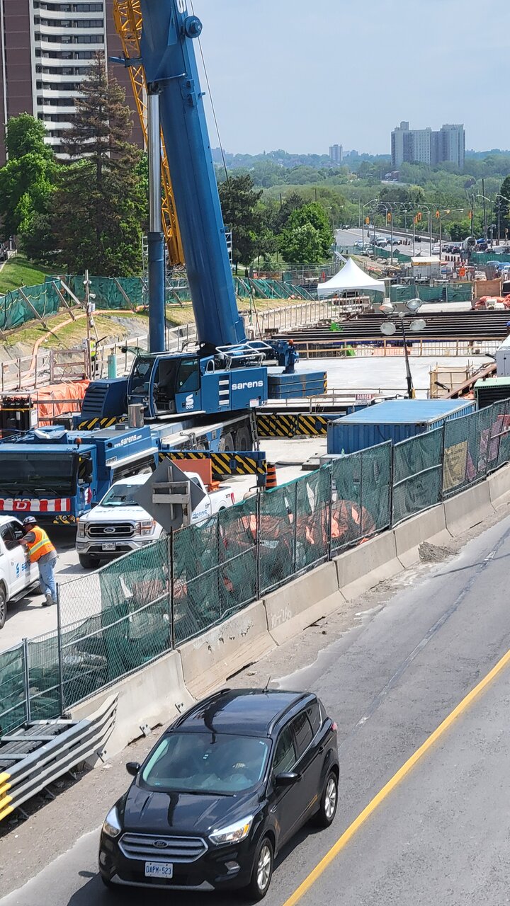

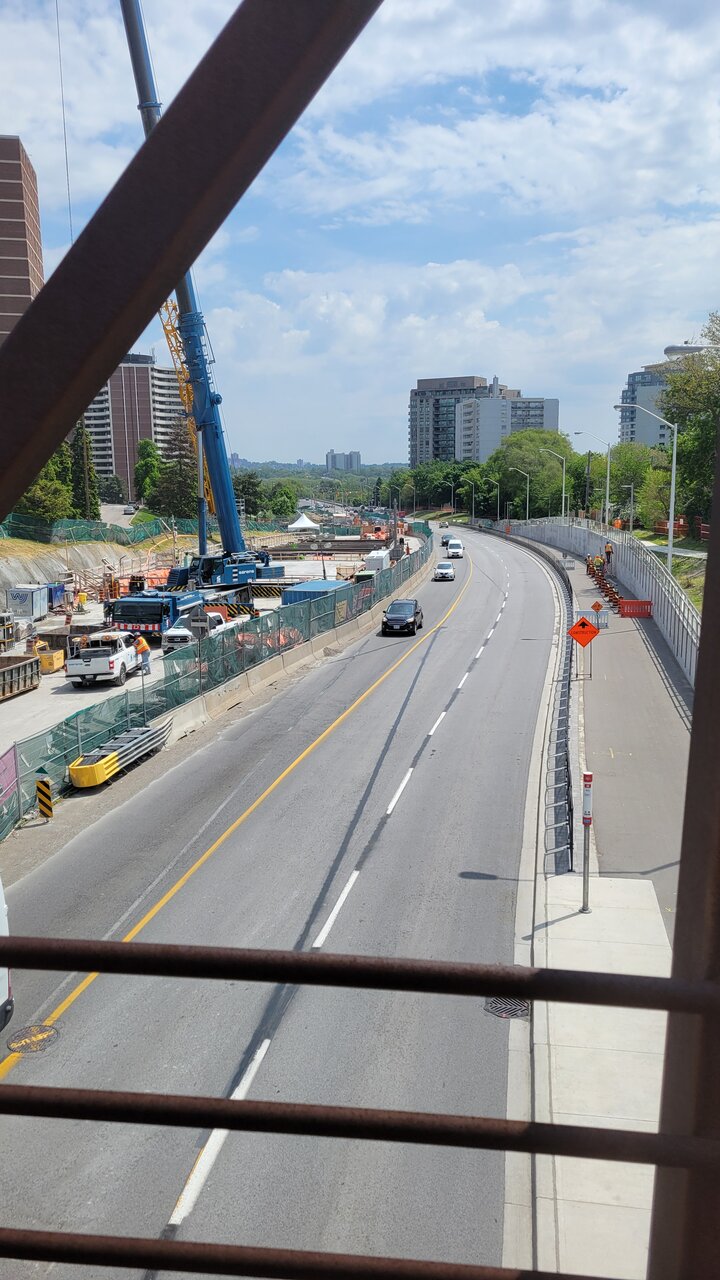

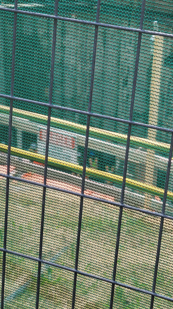

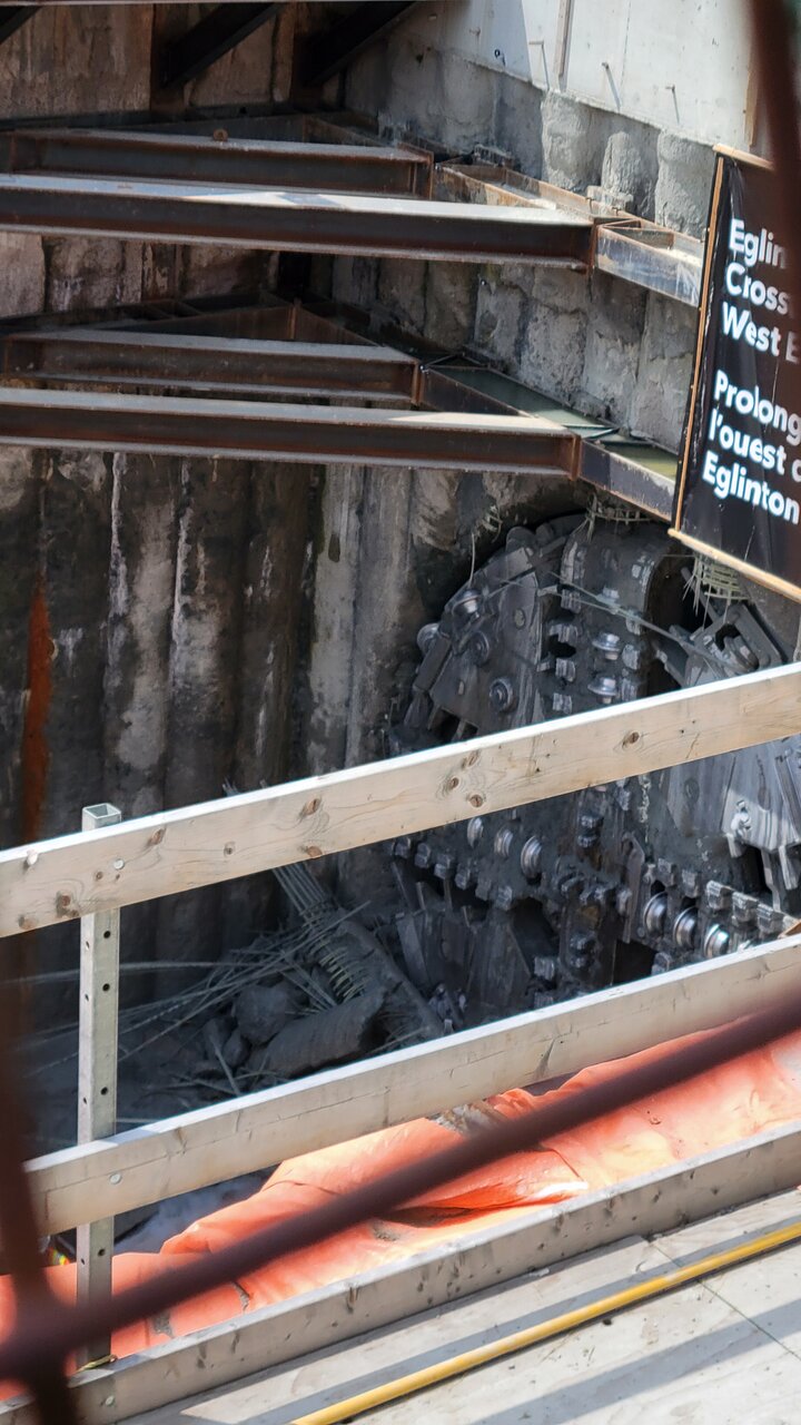

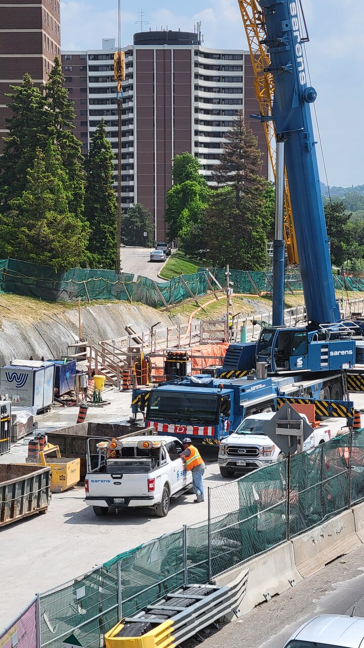

As it happens, I took some pictures of the site while walking my dog
First few are from the pedestrian bridge to the west of the Scarlett portal, the second batch of pics are from the path on the northside of Eglinton
Seemed like they were doing a celebration or recording a press release as there were a lot of people in the pit and they all cheered as I was walking past. Couldn't tell if the other TBM had been removed yet, but the crane looks position to do so.
What a timing of your walk! Yes, they were taking time lapse and probably having a celebration for tunnelling completion.
You can see the other TBM in the following post plus the timelapse. You happened to be in the right place at the right time.
Looks like the headwall breakthrough by the other TBM.
