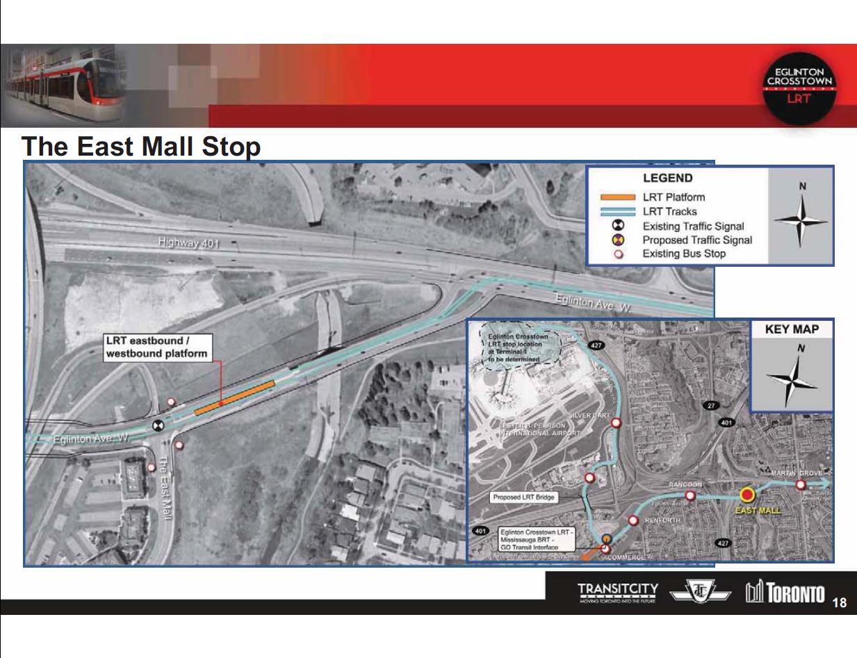

This intersection, or more accurately, intersections (plural), is the main problem with having an at grade LRT along Eglinton Avenue West.
While the East Mall stop has been removed, they still want the LRT to make turns crossing all the eastbound traffic coming off the 401, 427, and 27.
The current plans are for the LRT to emerge out of a portal on the east side of Eglinton Flats. However, the LRT would be in the middle of the Eglinton Avenue West roadway, running all the way to the 401/427/27/Eglinton intersection.

If the powers-that-be are so set on using at grade for the entire Eglinton West LRT, then they should set up the portal at Eglinton Flats to emerge on the south side of Eglinton Avenue West. Then by having the entire LRT right-of-way at grade level on the south side, by the time the trains get to Martin Grove and the 401/427/27/Eglinton intersection, they would already be on the south side. They'll avoid crossing the very, very, very busy traffic congestion by doing so.
