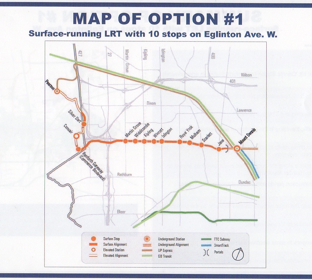

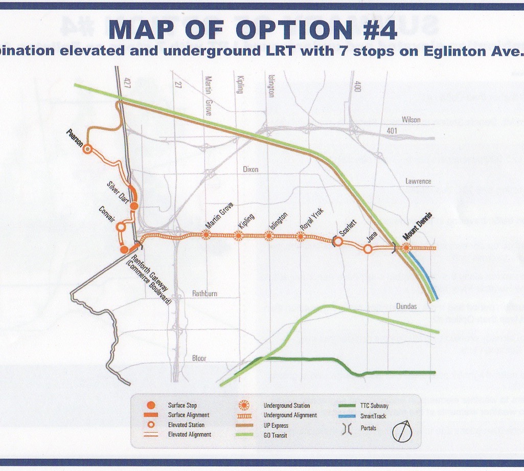

I can't see the merit in underground east of about Islington. One wonders if the underground spec was deliberately overdone for Options 2-4 with the intent of making them non-starters, leaving option 1 as the sole affordable option. I wonder what the incremental cost and travel time would be with only Islington to Martin Grove underground, with a 5a) option costed for five underground stations and a 5b) option costed for only three (Islington, Kipling, Martin Grove).
There are still no more details on the project website. http://www.eglintonwestlrt.ca/
Although Option 2 says underground, I can't imagine they mean the entire thing (i.e. under the Humber).
Option 3 is a joke (only 3 stops)
Option 4 seems the most reasonable. It would indeed be interesting to know which areas they are actually elevating and putting underground. Then we can know if the option was added seriously, or just to promote the preference of the design team.
^The handouts at the meeting had maps on them, showing the location of the underground portals. I will scan one if they aren’t on the city web site. All three (other than Option 1, obviously) showed the portals in exactly the same locations....roughly Scarlett Road and East Mall.
^ Mea culpa. I didn't get that exactly right. There are some differences in the Options. Option 2 is completely tunnelled, Options 3 and 4 are elevated over the Humber. Beyone Renforth, all options have the same mix of elevated and surface.
