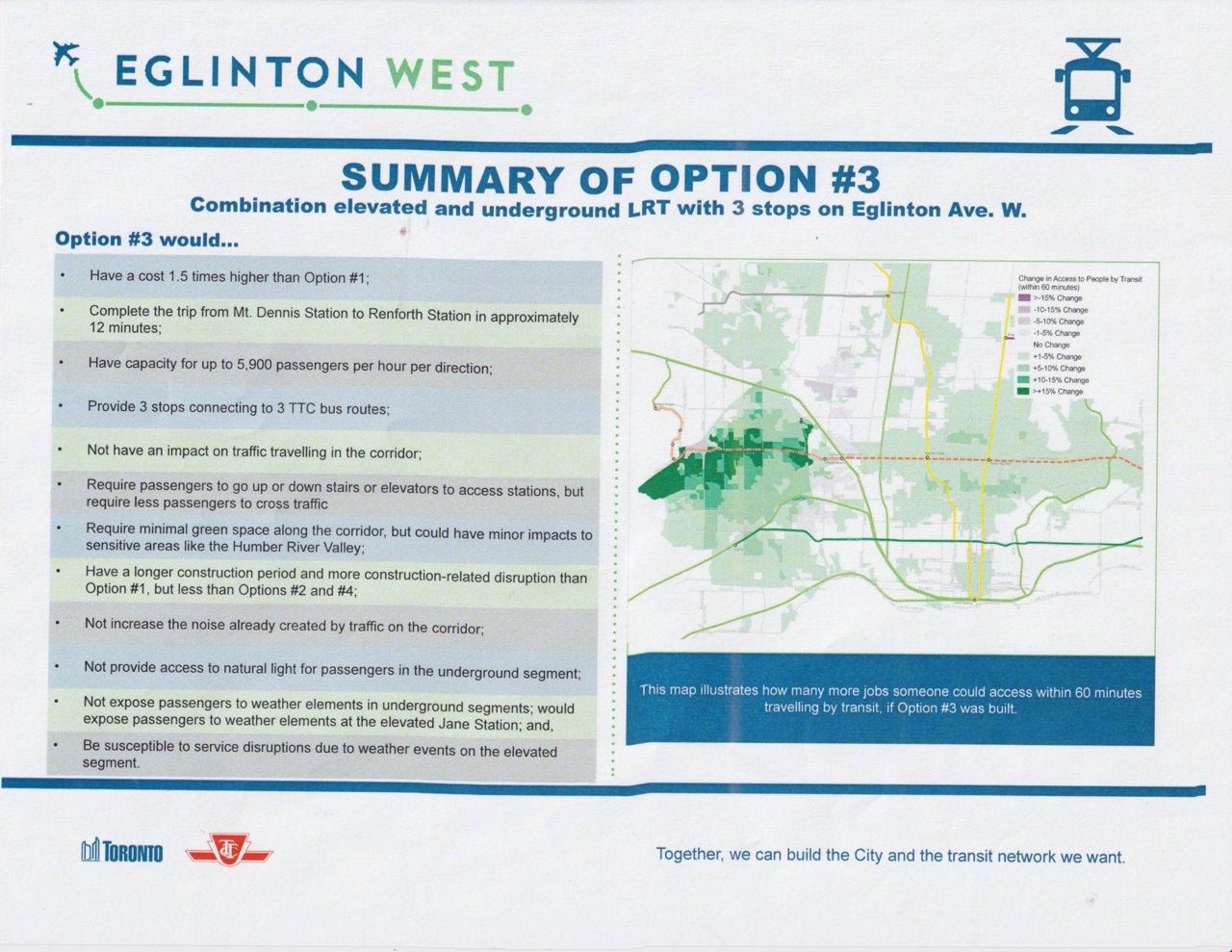

Interesting that all option have the same capacity.Scanned some handouts on the four options that they presented...
View attachment 175612View attachment 175613View attachment 175614View attachment 175615
does this mean that the St. Clair LRT has the same capacity as Eglinton between Dufferin and Yonge?
why bother putting DRL underground?
I suspect that option 2 will be chosen.Thanks to W.K.Lis for the detailed post.
My preference is Option 4. That option would provide decent local coverage (7 stops), combined with a good travel time (16 min from Mt Dennis to Renforth). Transit will become a viable option for many of the Airport area employees, as long as there is a shuttle bus that connects the Renforth stop to other parts of the employment district. If you live west of Yonge and not too far from Eglinton, that will be 10-15 min on a local bus to Eglinton, plus 10-25 min on the LRT, plus 5-10 min on the shuttle bus. Kind of reasonable.
The cost of Option 4 isn't huge compared to Option 1. Times 2.1, not times 4 or 5.
Option 1 is good for local service, but too slow to make the trips very appealing for the airport area employees.
Options 2 and 3 are worse than 4 or 1. Option 3 has too few stops, the loss of local access will not be compensated by the slightly faster travel time. Option 2 is both more expensive and less rapid than option 4, then what's the point ..
