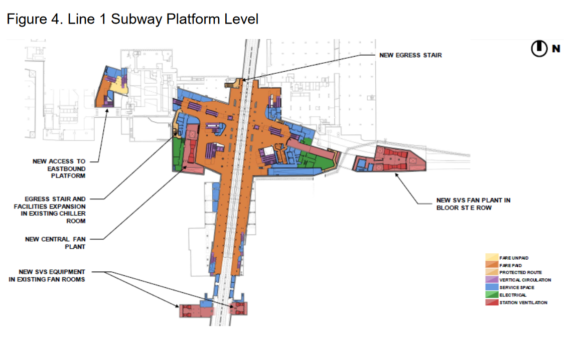

This is a new image that we really learn stuff from: Note that you see the existing and proposed foot print, and also the ownership division between Brookfield and Larco.

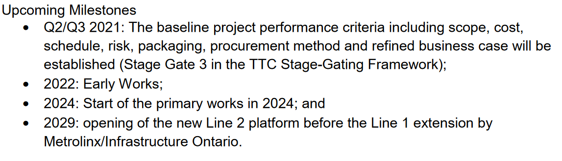

We also have a more detailed timeline:

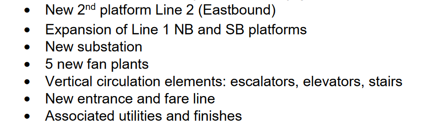

Some detail (still opaque) on scope:
Interesting, they moved away from having a staggered Yonge BD line station.

Notice that the new platform opens 2 years after the planned opening of the OL, which means it won't come until after much of the transfer traffic has been diverted.
Also, I find it ridiculous that they spend $1 billion on safety upgrades to this station and don't include PSDs??? If you're spending the better part of a decade and a billion dollars rebuilding this interchange for safety reasons, then I would expect barriers to the tracks to be part of the scope. Unless they're planning to shut down Yonge-Bloor again just a few years later. Line 2 is supposed to be done resignalling for ATC by 2029 since the SSE will be ATC-only.
