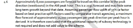

Current peak ridership of SRT: 4,500 pphpd; and TTC has to run parallel express bus because SRT cannot handle all peak demand.
Forecast subway ridership for one-stop plan: 7,000 pphpd (in the SSE docs).
Forecast subway ridership for the 2013 three-stops plan: 14,000 pphpd (in the SSE docs as well). Honestly I think the latter number may be overestimated, but even if the real number is 10,000 or 11,000, that shows the potential of the corridor.
Yes, but a) custom-made small cars will cost more to purchase, b) small cars will limit the capacity.
And c) the city will have re-hash the same subway vs LRT (vs some new technology?) debate 25 or 30 years from now, when the new SRT cars become old again.
Hence, my preference is to build the subway and be done with it. The funding is aligned right this time.
Forecast subway ridership for the 2013 three-stops plan: 14,000 pphpd (in the SSE docs as well). Honestly I think the latter number may be an overestimate, but even if the real number is 10,000 or 11,000, that shows the potential of the corridor.
That's a fraction of the Sheppard Line even at about 50,000 per day.
? pphpd means per hour, per direction
Sheppard subway is about 5,500 pphpd, certainly less than the forecast for SSE (even in the 1-stop configuration of the latter).
