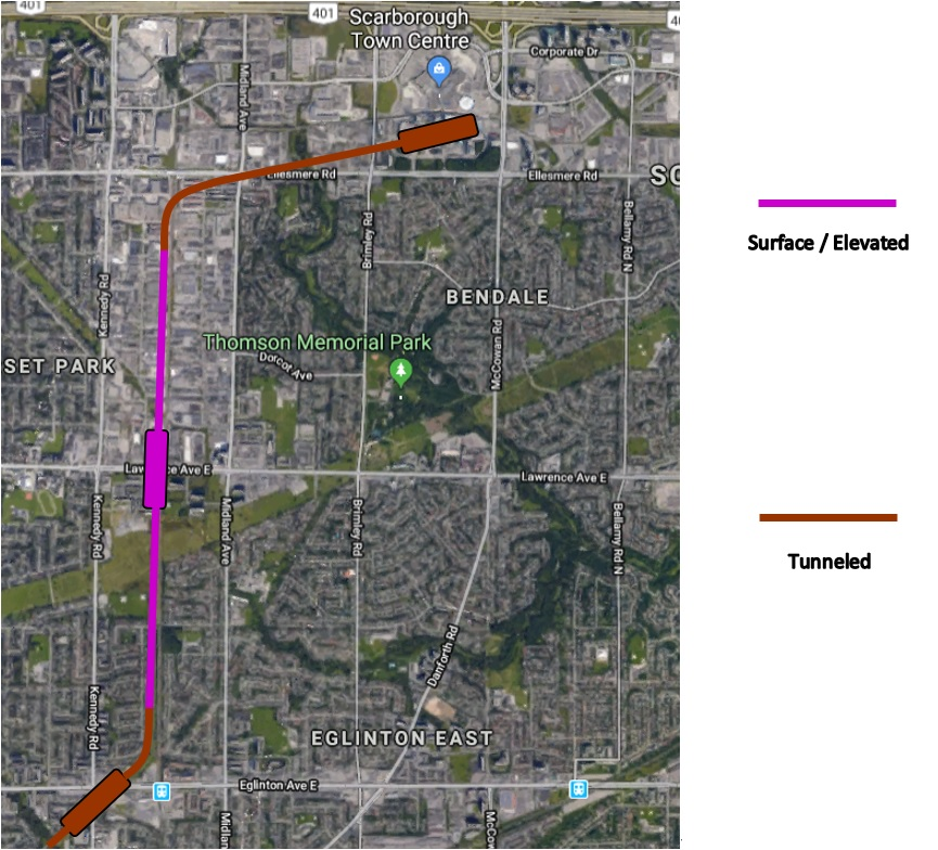

There may exist one more routing option for SSE, mostly utilizing the Uxbridge Sub corridor, but not exactly the one included in the previous studies.
Of course, this is only relevant if the corridor is still available for non-RER rail. If Metrolinx has decided, unofficially but firmly, to reserve the corridor exclusively for RER, then this option is moot.
Details:
- A new Kennedy station (underground), located west of the Uxbridge corridor and oriented diagonally to the street grid;
- Past the new Kennedy station, the line veers north until it aligns with the west side of the Uxbridge corridor, then emerges;
- There would be a 3 km long surface section, that includes a Lawrence East subway station on the bridge over Lawrence Avenue;
- About 500 m south of Ellesmere, the lines goes under, then veers east towards STC.
Advantages:
- Hopefully a cost reduction, as the tunneled length (including new Kennedy Stn) would be approx. 3.5 km, versus 6.5 km for the McCowan route. We can expect a 20-25% cost reduction.
- Lawrence East station is back.
- The location of the STC station might allow the existing bus terminal to be reused.
Unlike the studied "SRT" route that includes an elevated section approaching STC, this proposal has a tunnel to STC. That avoids problems with the turning radius from N-S to E-W, and with the elevated guideway's width. Concerns about the visual disruption caused by the guideway would be moot as well (although I don't regard that to be a show-stopper in the first place).
Details:
Advantages:
Instead of having it on the surface/elevated, would it be possible to build it cut-and-cover IN the rail corridor? This would allow for potential cost saving from having the TBMs go all the way along McCowan, and it would allow the double/triple/quadruple tracking the rail corridor ABOVE the subway tracks. It could also have a shared ST/RER and Subway Lawrence East Station, with platforms stacked.

Potentially yes, but I am not sure that in the cut-n-cover case, there will be enough saving (compared to the McCowan route) to justify the whole exercise.
People keep saying cut-n-cover is cheaper and that's probably correct, but how much cheaper? On the other hand, we are adding the cost of building the new Kennedy station.

My proposal is surface where not tunneled; not cut and covering. That should result in both a greater amount saved, and no need to shutdown the GO line.
RT would have to be shut down and that's an inconvenience, but you can't have a perfect solution that keeps all stakeholders absolutely happy. Some sacrifices will have to be made, one way or another.
