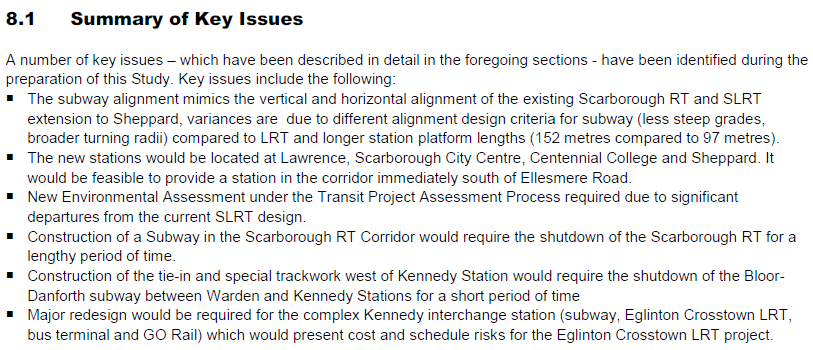

The Metrolinx report suggest the shutdown can be short - it's identified as one of the issues in the report (p. 24/27 of PDF)

That Metrolinx report said the Warden-Kennedy shutdown would be brief. We'd be looking at similar scale to the Yonge Line shutdowns planned for this summer.
