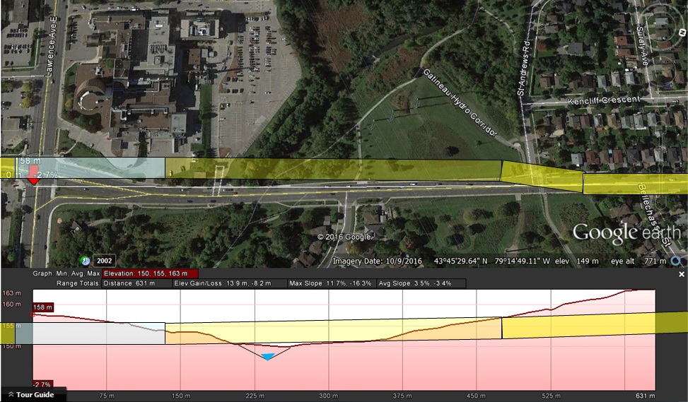

The key to cut-and-cover is to find a way of handling the hospital. I sketched up an B-D line that is just west of McCowan (note that North is right). Google Earth elevations are not that accurate, so I am not sure if things are correct. Once you clear the hospital, everything else can be cut-and-cover - unless you want to go to Sheppard than TBM is required under 401).
The Station is underground at Lawrence, but extends north and becomes roughly at (near)-grade as McCowan dips about 3.5%. The subway would be on a bridge, about the same elevation as McCowan. After crossing Highland Creek, the line would go underground and curve to continue north under McCowan. I have now blocked access to the hospital, so that needs to be worked out.
I would have loved to raise the elevation of McCowan and just put the subway under the bridge, however, the line would not be underground in time for Benleigh Drive and access to that road would be blocked.
