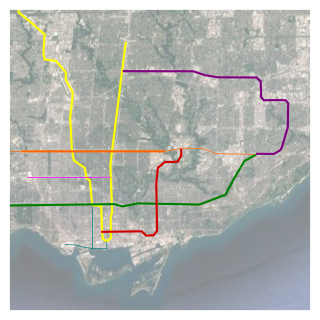

Was playing with an old template I had, so it's shoddy. But just wanted to see how it looked and to gauge whether it'd be palatable. Basically this would follow the exact same SSE McCowan routing, but as a separate line (i.e not an extn of Line 2). It could be built above-grade from Kennedy stn to Danforth Rd/Eglinton, then deep bore from there to Triton/McCowan. Since it's not an extension of Line 2 people will be miffed about not being 'connected' etc, but the bonus would be that it's interlined with a Line 4 extension. This could be built as affordably as possible, and the whole thing would be spec'd to 4-car/100m trains max. One could argue that it's a light metro/subway and is somehow insufficient, but it's still very much a subway and would be very much sufficient.
I don't actually support building an orbital or suburban circle line, but if it's done affordably, can appease the masses, and can kill two birds with one stone (i.e see stations like Lawrence E added and finally put to rest speculation re: Line 4) then I think something like it should be pursued.
