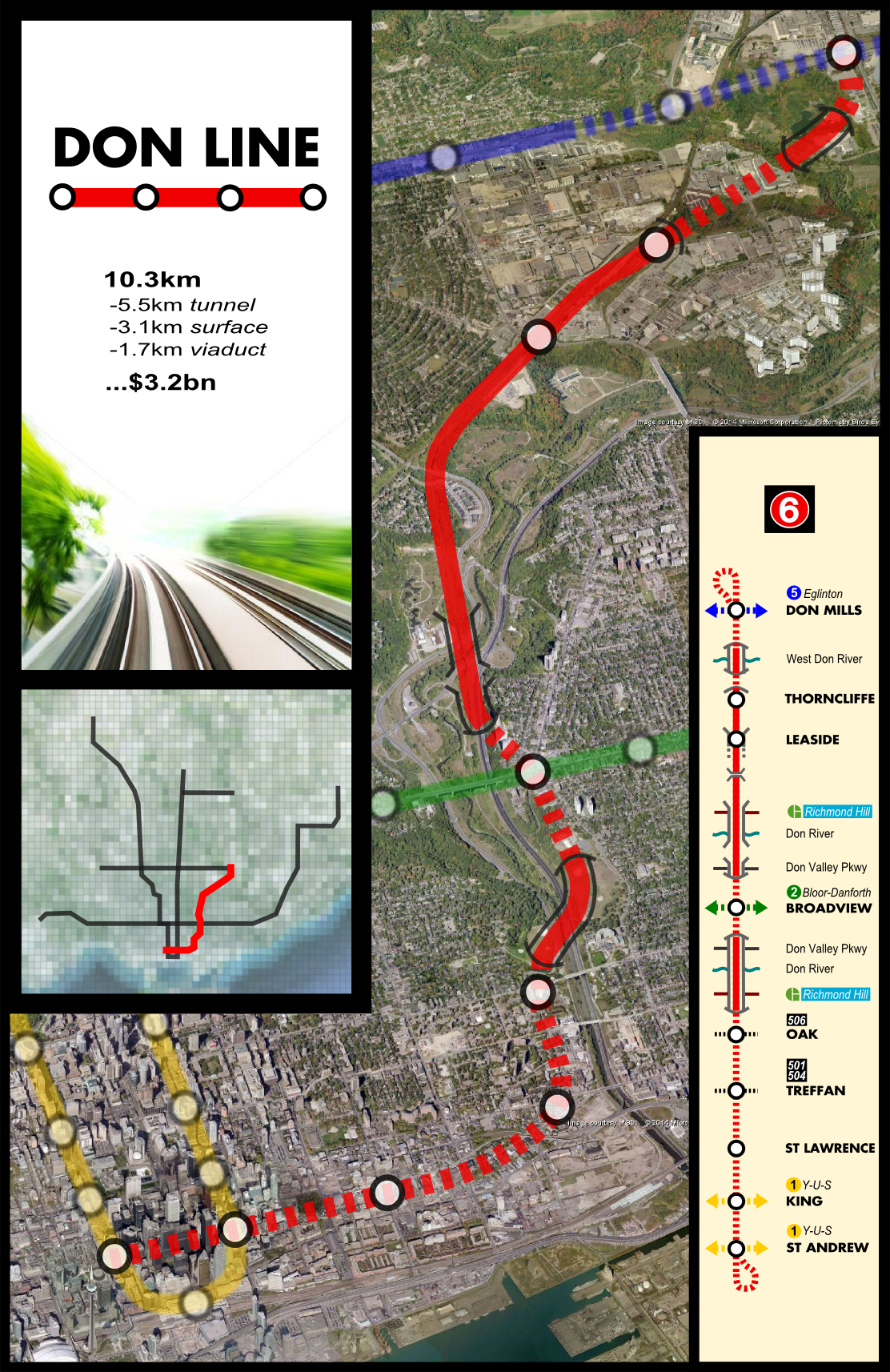

Perhaps 44North's DRL alignment idea is what should be considered instead of the traditional DRL alignment:
attachment.php
What about changing the downtown alignment of this route to using Parliament instead though?
