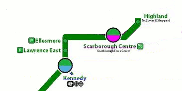

With the whole province versus city debate on the route for the Bloor extension, maybe the best solution is a compromise. It would partly run on the SRT route, serve Scarborough Centre more centrally, and connect to Sheppard more quickly.
The two people who are in the best place to propose a compromise are Murray and Stintz. They have the technicals experts of Metrolinx and TTC behind them who came come up with a solution to satisfy all sides. Unfortunately, these are the two individuals who are the source of much of our existing troubles. Either Metrolinx and TTC are too stuborn or incopetant to find a solution, or they have a solution but Murray and Stintz are too stuborn to propose it.
