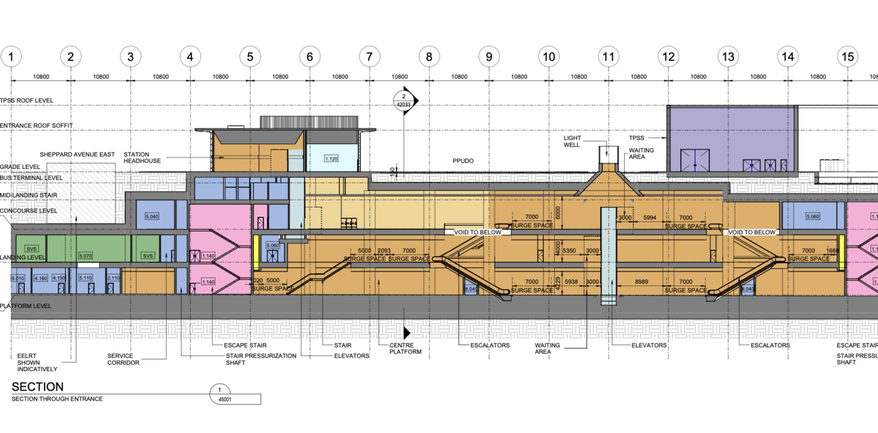

Look at the pathetically sized light well at Sheppard/McCowan - tiny, and surrounded by a PPUDO. Why not larger, and considering the whole design of the station around it?

And I don't mean "I want starchitects and giant stations" - you can have beautiful, thoughtful, standardised, well sized station designs (as in Copenhagen) - or a kit of parts approach, like the central tunnels of Crossrail.

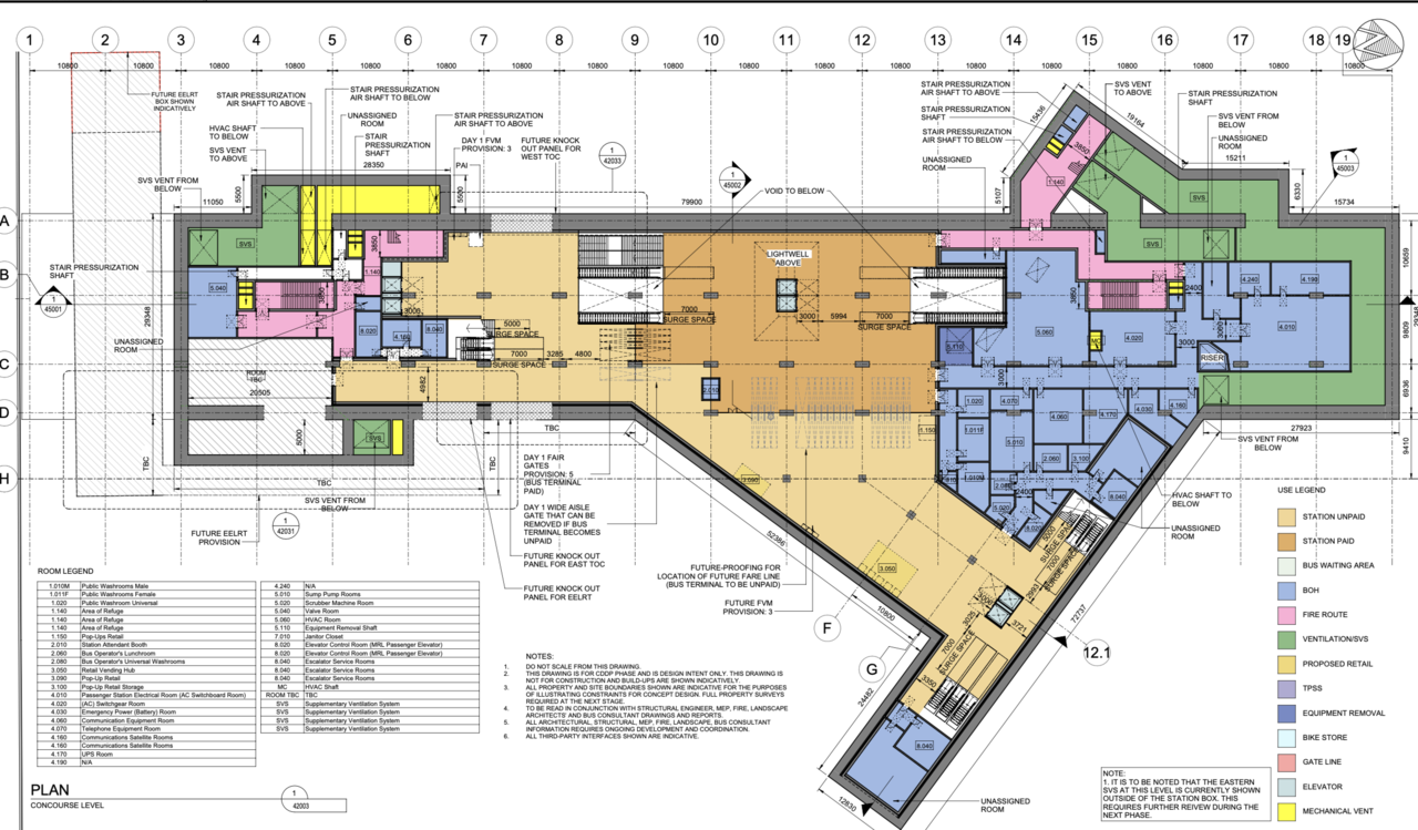

My surprises from the architectural plans:
  1. Good: Bus terminals with some canopy (it would be nice to have a bit more overhang)
  2. Bad: No underpass or overpass to get people across streets at Scarborough Centre or Sheppard, not even a basic set of stairs. It is one corner of the intersection access.
  3. Interesting: Bus terminals are completely in an unpaid zone (as is LRT, but not Line 4). I would have expected a paid zone or mix, but I guess the evolving pricing models for transit in the GTA are going to want people to tap onto the subway when getting off or on a bus/LRT. It suggests that subway will become more aligned to rail pricing (tap on and maybe off the subway?), while surface LRT aligns to bus pricing.
Interesting that the "Day 1 Fare gates" at Sheppard/McCowan assumes the bus terminal will be a paid zone... but the design of the station futureproofs a large number of fare gates for an unpaid bus terminal...
Would that be for a hypothetical Durham Region BRT connection, maybe?
The Durham/Scarborough BRT has always been planned from STC along Ellesmere. The Toronto portion is unfunded and did face local opposition (Highland Creek)... No word beyond that at present.
Other DRT routes would still service Sheppard and I would assume some space for DRT may be included at Sheppard/McCowan.
