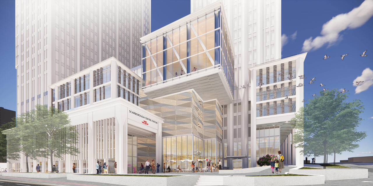

What provisions are being made to make it a good experience going from the new Scarborough Centre Station to Scarborough Town Centre mall? Is there an underground connection to the existing entrances or just a sidewalk?
Latest render

The design you shared is the old design from 2018.
Now the station and bus platform are completely east of McCowan.
There is no indication of any sort of connection or pathway to the mall anymore. It will be a 500m walk outdoors to get to the nearest mall entrance.
A tower opposite the station on McCown will have a second entrance to the station. But I dont think there is a path through the building to the mall either.
A tower opposite teh station on McCown will have a second entrance to the station. But I dont think there is a path through the building to the mall either.
Ah that makes sense... must've been a change when they moved to the three-stop extension. explains the large bus terminal at Shephard and McCowan too.
There could still be provisions made for an enclosed link to the mall however... I know they want to tear down the Cineplex for development. Would be easy enough to leave knockout-panels beneath the "two-towers" block
