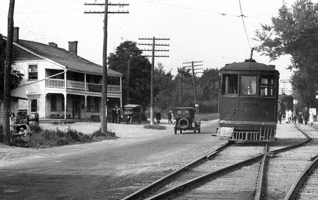

Well a long time ago there was the Toronto & Scarboro Radial Railway which ran from Kingston Road and Queen to what is today Morningside and Lawrence.
Note that the streetcar/radial car is on its own right-of-way, separate from the traffic lane or lanes. When they were forced to provide more spacious traffic lanes, they took the real estate from the right-of-way and turned it over to the automobile.
Toronto & Scarboro Radial Railway service ended in 1936; the street traffic was very light at that time.
The streetcars had their own right-of-way because it was easier to build and maintain rails not covered by asphalt. Not to protect the streetcars from then-nonexistent traffic jams.
