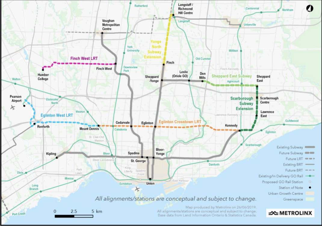

The Ontario Line Business Case shows the Scarborough Subway Extension having the normal 3 stops.
