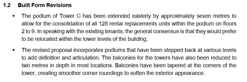

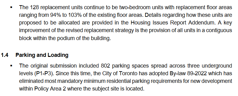

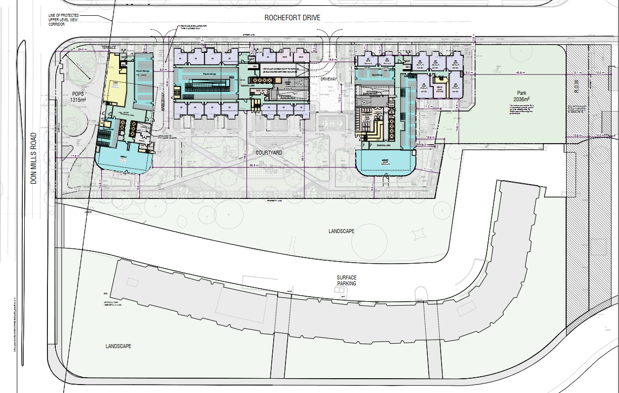

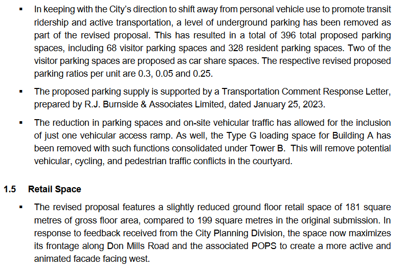

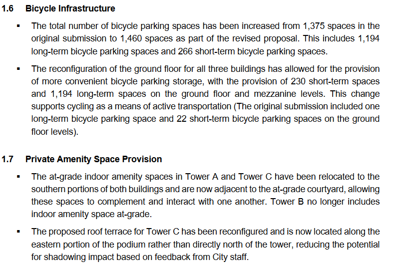

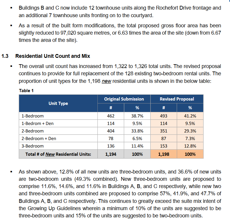

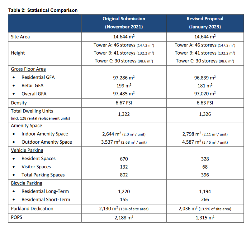

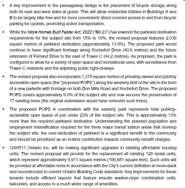

Good to see the parking cut down considerably. But let's see what else changed; from the Cover Letter:
* someone missed a policy guideline, unless it has been revised; The Arch. File is over 68mb! @innsertnamehere

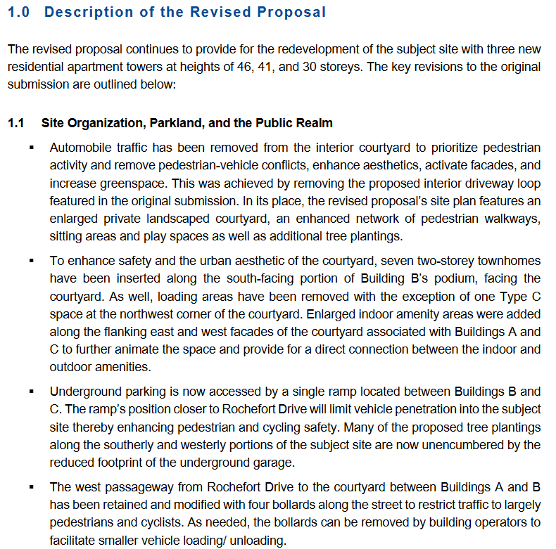

Revised Site Plan:

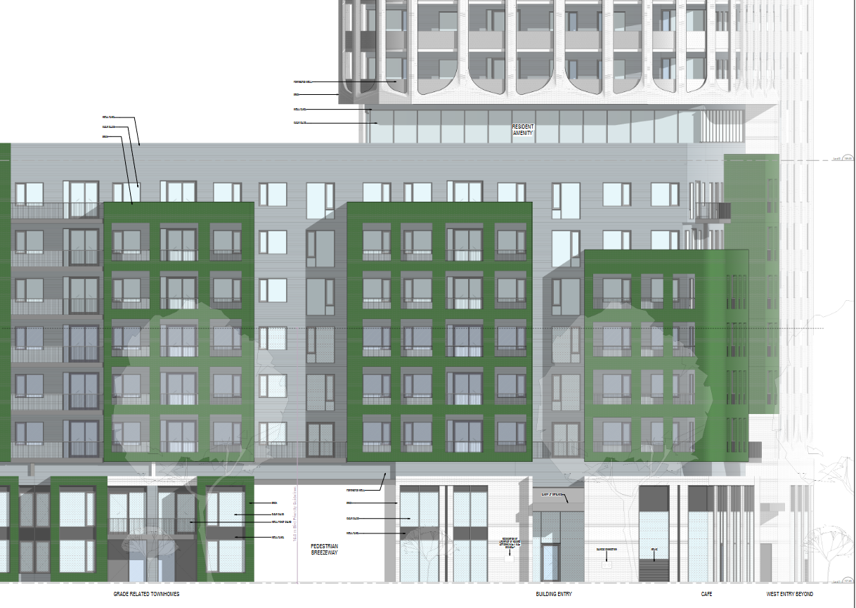

Podium on these does not work for me:

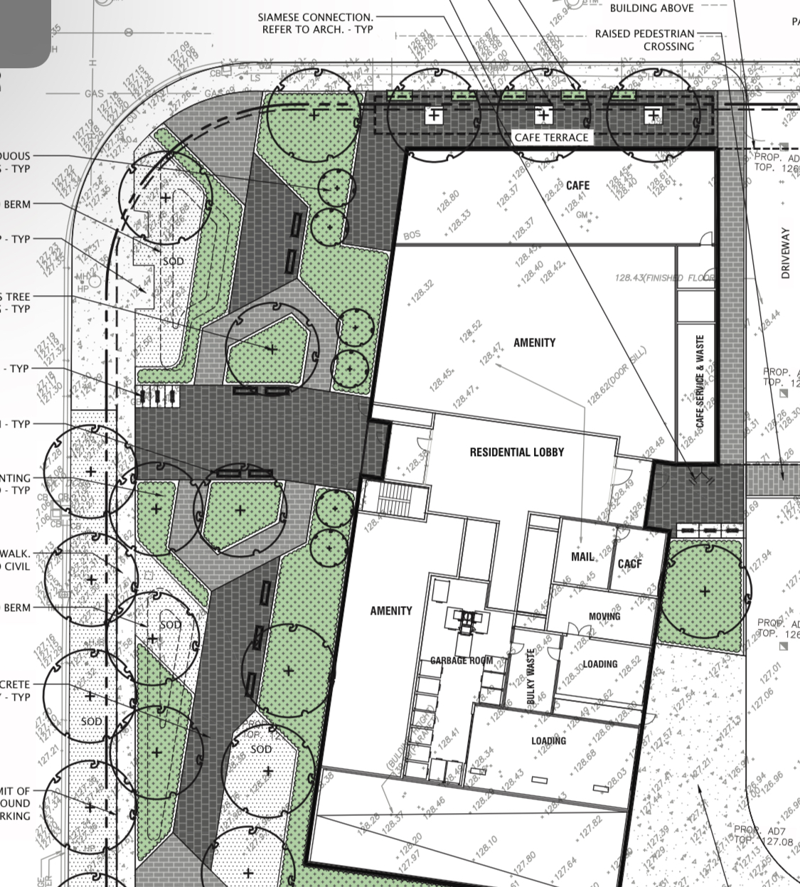

I didn't have a chance today to pause, reflect and comment in detail here, and frankly, I still need more time.
That said. I am 110% in agreement on number 3.
In fact, as I look at it, they shrunk the park space at the east end of the site in a peculiar way, and grew this rather strange looking and non-functional plaza at the west end. I really don't like that.
Some room for a wider sidewalk to support a patio, great, but otherwise, keep the site 'urban' and 'animated' by keeping the retail experience as close to Don Mills as is practical.
Everyone knows how I feel about really small parks with irregular shapes; my opinion hasn't changed. Make it functional or don't waste the time, money and land.
I'm not sold on the green here.........but I'll give that more thought.
The rest I equally need to think about.......but I have to say, I'm just not sold that they've got this right yet.
