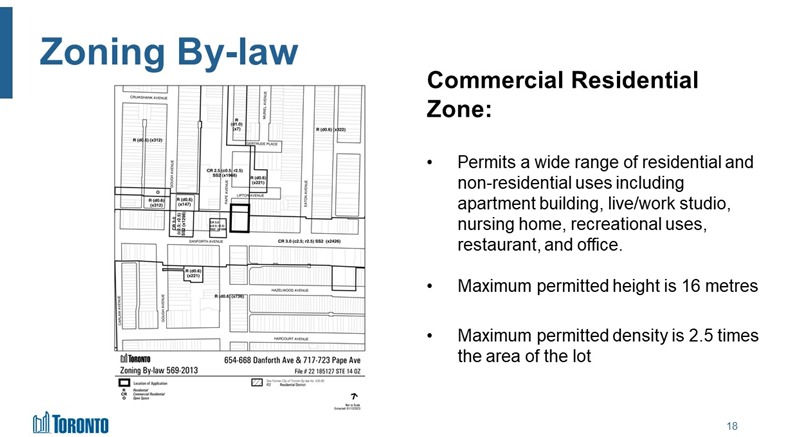

NOTE : Current MAXIMUMS are laughably low, and City Planning / City Council should hang their heads in shame about those ZONING numbers.
