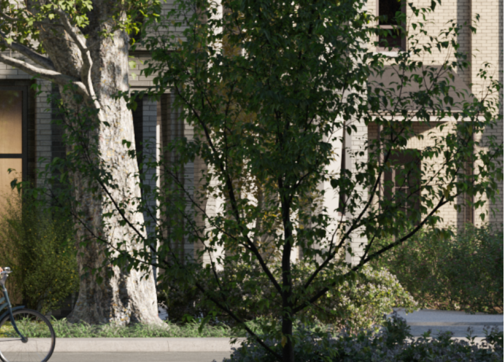

Multiple Tree removals are proposed, but I find these two noteworthy, (picture below) as they are in 'good' condition and are very large and currently in the front yards of the homes here:
The stated reason for removal of both is conflict with City guidelines for a 2.1M sidewalk, and root encroachment. I will simply state that neither is functionally reasonable in opinion.
Just noting that these trees are retained (with injury) in the resubmission

Resubmissions (March & May 2025) primarily addressing feedback from staff with revisions to podium massing, heritage reveal, loading space & bicycle parking among other technical changes. Proponent is also working with city staff to reimagine a section of Cawthra Square as a pedestrian entrance to Barbara Hall Park.
Updated renderings:
PLN - Renderings or Perspective Drawings - Renderings_2-12 Cawthra Square_March 14 2025-0.jpg
PLN - Renderings or Perspective Drawings - Renderings_2-12 Cawthra Square_March 14 2025-1.jpg
PLN - Renderings or Perspective Drawings - Renderings_2-12 Cawthra Square_March 14 2025-2.jpg

Let's take a look at how the relationship to the retained heritage has changed: Previous version first, new version below.
This is almost exactly in line w/my suggestion here. I'm pleased.
Note that some of @AlexBozikovic 's comments below were also addressed:
The design of the base looks like a student project.
Diagonal exoskeleton (why?) + oddly shaped windows with competing diagonals + weird stained glass to honour the heritage + too many materials + lots of curtain wall which will get VEd.
Diagonal exoskeleton is gone. The overhang has been pruned back just a bit as well.
