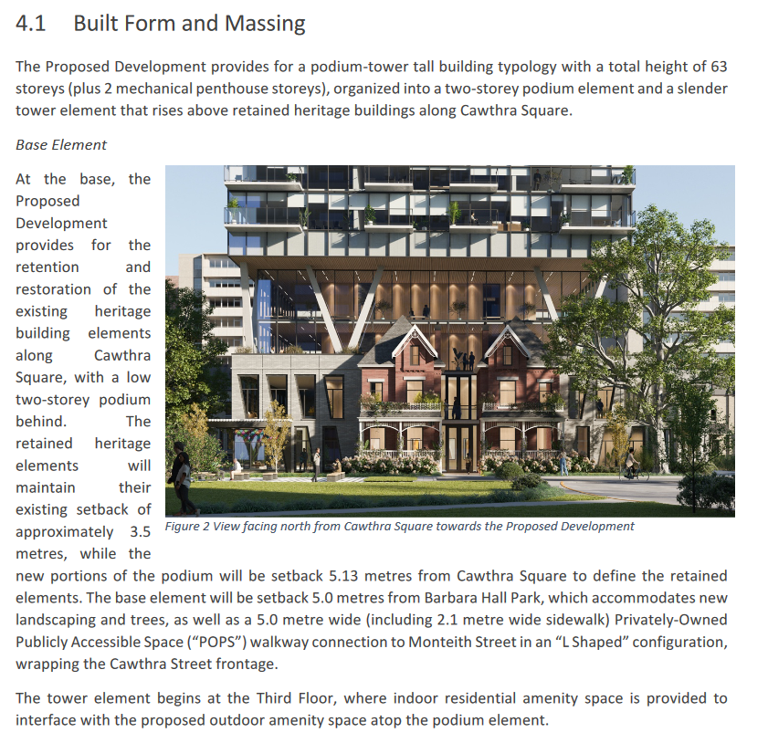

Both 6 & 8 Cawthra Square were designated (Part IV designation) by council in June. We now have a resubmission incorporating the heritage structures as well as a height boost:
Additional stat changes are as follows:
  • Storeys increased from 45 to 63
  • Height increased from 145.4 to 206.97m
  • Total residential units increased from 488 to 590 (incl. 14 rental replacement)
  • Below grade levels reduced from 4 to 2
  • Total vehicular parking decreased from 119 to 26
  • Total bicycle parking increased from 548 to 650
  • Primary architect changed from Arcadis/IBI to ZAS Architects

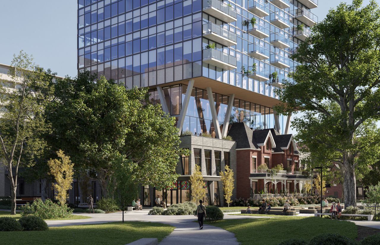

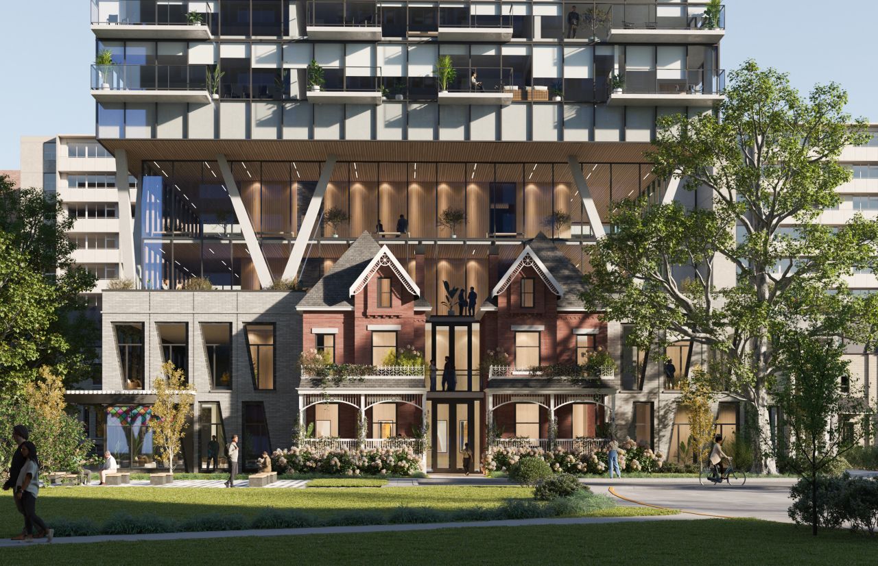

Updated renderings:
PLN - Renderings or Perspective Drawings - Rendering One_2-12 Cawthra Square_Oct 15 2024-0.jpg
PLN - Renderings or Perspective Drawings - Rendering Two_2-12 Cawthra Square_Oct 15 2024-0.jpg

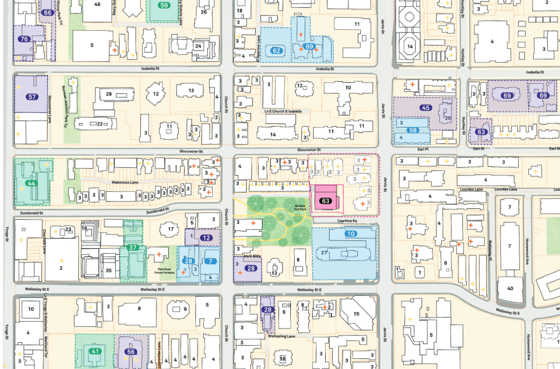

The Block Context Plan suggests the ask isn't out of reach....

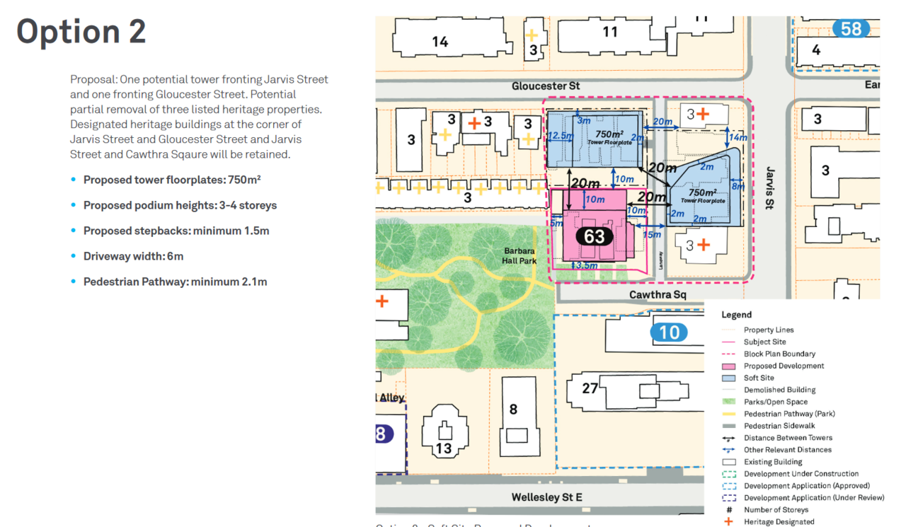

More interesting is what's intimated:
Do you wonder how hypothetical those are? ...............

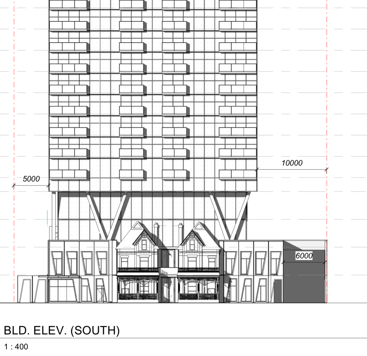

Comments, better, preservation/restoration of heritage facades, retention of many mature trees. Would still benefit from further refinement.
Despite falling within tall building design guidelines........the tower reads a very bulky relative to the heritage facades, there's a need to do better there. It may require smaller floor plates, but I'm not settled on that.

Interesting. Just some numbers if the idea of four towers materializes: units - 2,360 and assuming 2 peeps/unit - 4,720.
And this is on top of whatever happens from Earl down to Wellesley on the east side. Would this trigger a new library/community centre/school? I wonder if a subway under either Jarvis or Sherbourne has ever been contemplated?! 🤪🤔
The design of the base looks like a student project.
Diagonal exoskeleton (why?) + oddly shaped windows with competing diagonals + weird stained glass to honour the heritage + too many materials + lots of curtain wall which will get VEd.

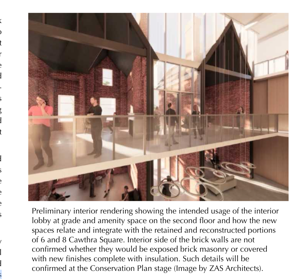

The retained portions of the houses are fragments in an atrium.
Also: where is the driveway entrance in these renders?
Agreed.
Should this actually go ahead (I'd prefer it didn't)..........
Non-heritage components in the base should be complimentary/sympathetic, not pastiche, but also shouldn't be jarring/distracting, you want to let the heritage shine.

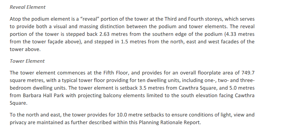

If one could make something work here, the tower needs to be pushed further away from the park, but also further back, this, of course, would require the purchase of additional properties not within the assembly. (or LDAs)
The (proposed) building pretty much goes to the rear lot line, with the tower set-in 10M specifically to allow for a tower to the north, with similar provisions to the east.
They are hamstrung by an assumption they must facilitate the development of others, where I don't think they can deliver a particularly good building here, and preserve the same ability for every abutting property.
Agreed. Though, I think it's fair to ask what the purpose of the heritage retention is here. If the purpose is simply about creating a visually appealing base building, with a heritage-feel...... you don't require a ton of depth for that.
However, this would certainly benefit from more, from at least partial returns, and some level of treatment that might make the heritage appear to be something other than a movie set for the pedestrian walking by.

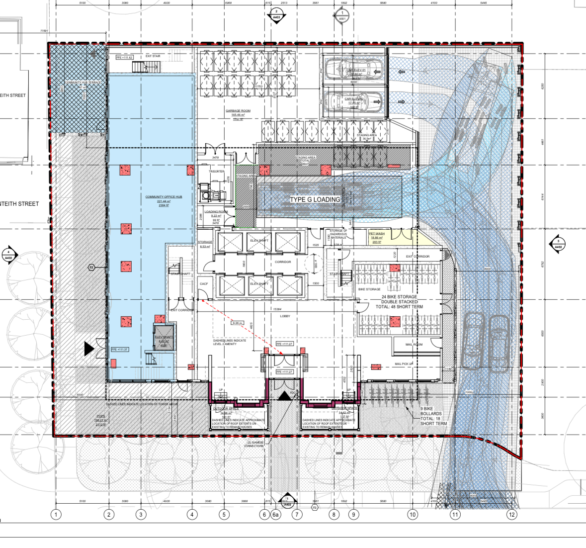

Good catch!
Clearly it remains a part of the arch. plans, (they need loading anyway) but it is not rendered at all, so far as I can discern. Which impacts both the apparently building, but also the landscape. That's quite misleading!
The facades gives 1 Bedford a run for its money. This isn't preservation. Just put the designated properties out of their misery.
View attachment 613300View attachment 613301View attachment 613302View attachment 613303
This is all extremely stupid, but the garage entrance is here, hidden by foliage:
