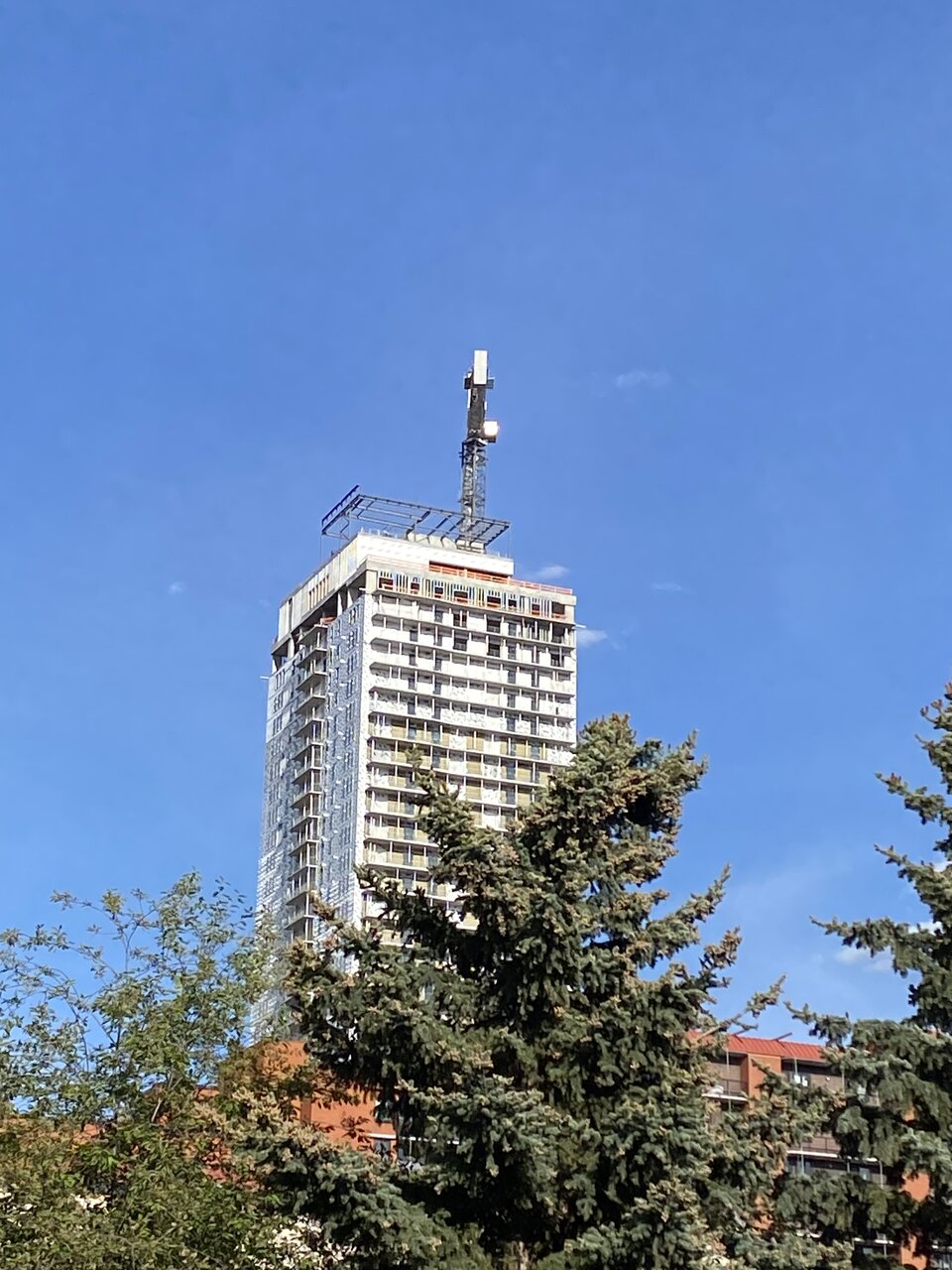

Is it common for buildings to be topped out before the cladding is started to be added or could there be some sort of issue they are running into with what they were planning on going with (functional, aesthetic, or supply issue)? It was a lot of months ago now that the first small section of likely test pieces were put up.
The panelization on 3 sides of the building (there are 5 sides) requires that 2 (or 3) storeys are fitted in place at the same time so that the skin on these sides has to be ready top to bottom -- these elements will get added very quickly by crane and so the subsurface needs to be uniform before the job begins. The balcony areas are a different matter but they are likely not on the critical path and they may want to have the balcony components in place first. Every project is different.
I'm also curious if there are shipping issues with global events currently taking place. Ships are rerouting and taking much longer than normal these days, so I suspect that would and could easily cause back logs.
