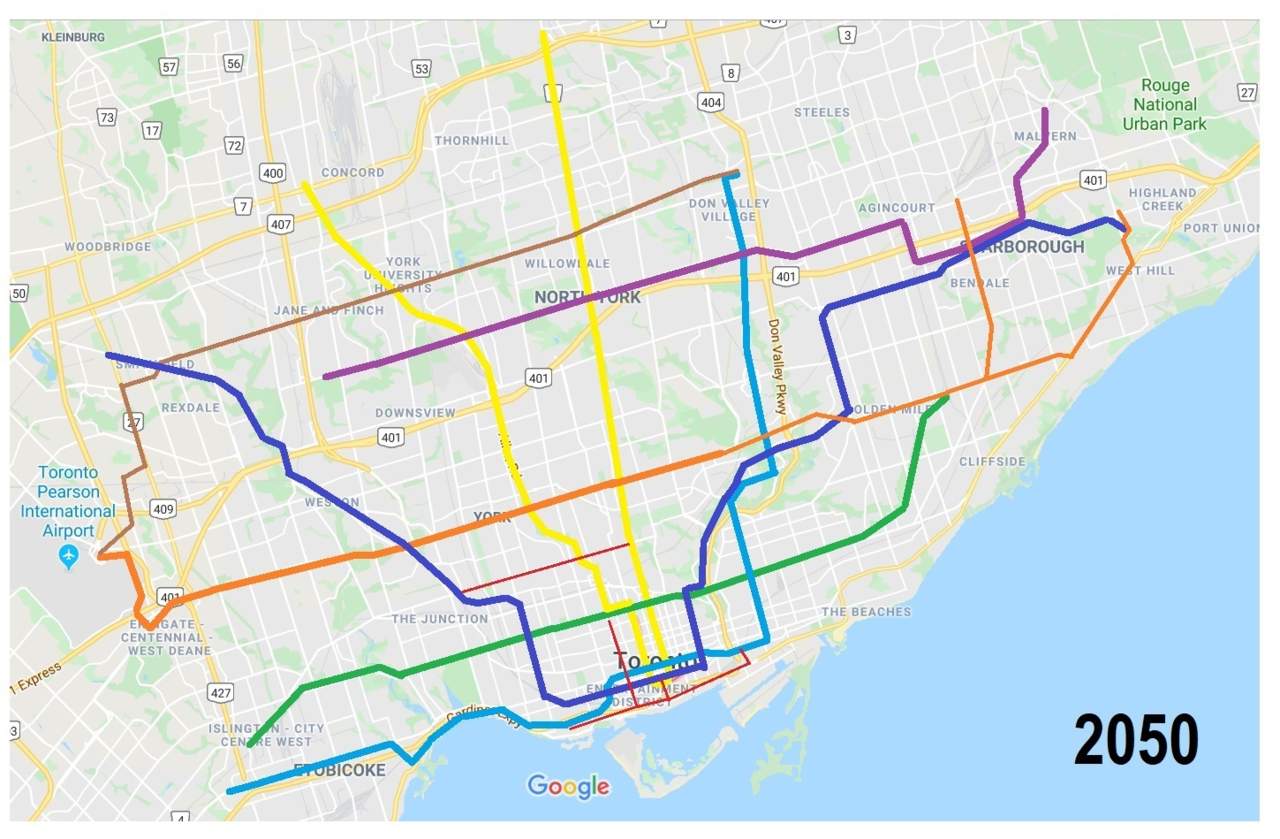

Interlining is a way of getting a new line, of sorts, into the downtown. It essentially means that every second train from East or West goes directly downtown.
The purpose of interlining is to reduce transfers. If these locations (East and West) have direct access to downtown, it means less transfers.
The only reason of decoupling is to allow for interlining, which allows for direct access to downtown for more people.
As you can see, my long term vision does have more lines going to downtown. First, the Ontario Line, which would intercept people before they get to the Yonge Line. Next is the Scarborough Line, which allows those in the NE to directly access downtown without transfer. This would also go up the NW side.
I don't like branches that have half service - unless the branch is built in some type of right-of-way where the cost is much lower. As you have shown, I imagine both Relief Line branches would be mostly tunneled, but only have half service each (because the Dundas portion would have the regular service). Of course the specifics of the Relief Line routes can easily be debated.
I'm not an expert, I'm not going to debate specifics. I'm imagining that the Scarborough branch of my relief line would be a sort of express service towards Kennedy or STC, skipping everything between Kennedy and Coxwell. With the current proposal for DRl, we are just shifting pressure to Pape.
I think that the downtown section of my RL would be 4 tracked, even though I know it would be expensive. I think that it would split off into 2 branches in the east too, one to Etobicoke and maybe Mimico, the other heading north towards York and joining and even replacing service on Line 1 north of Lawrence or something.
Also, I know we are going to need extra capacity. My line essentially offers maybe 30-50 years of relief, before we need a new line.
