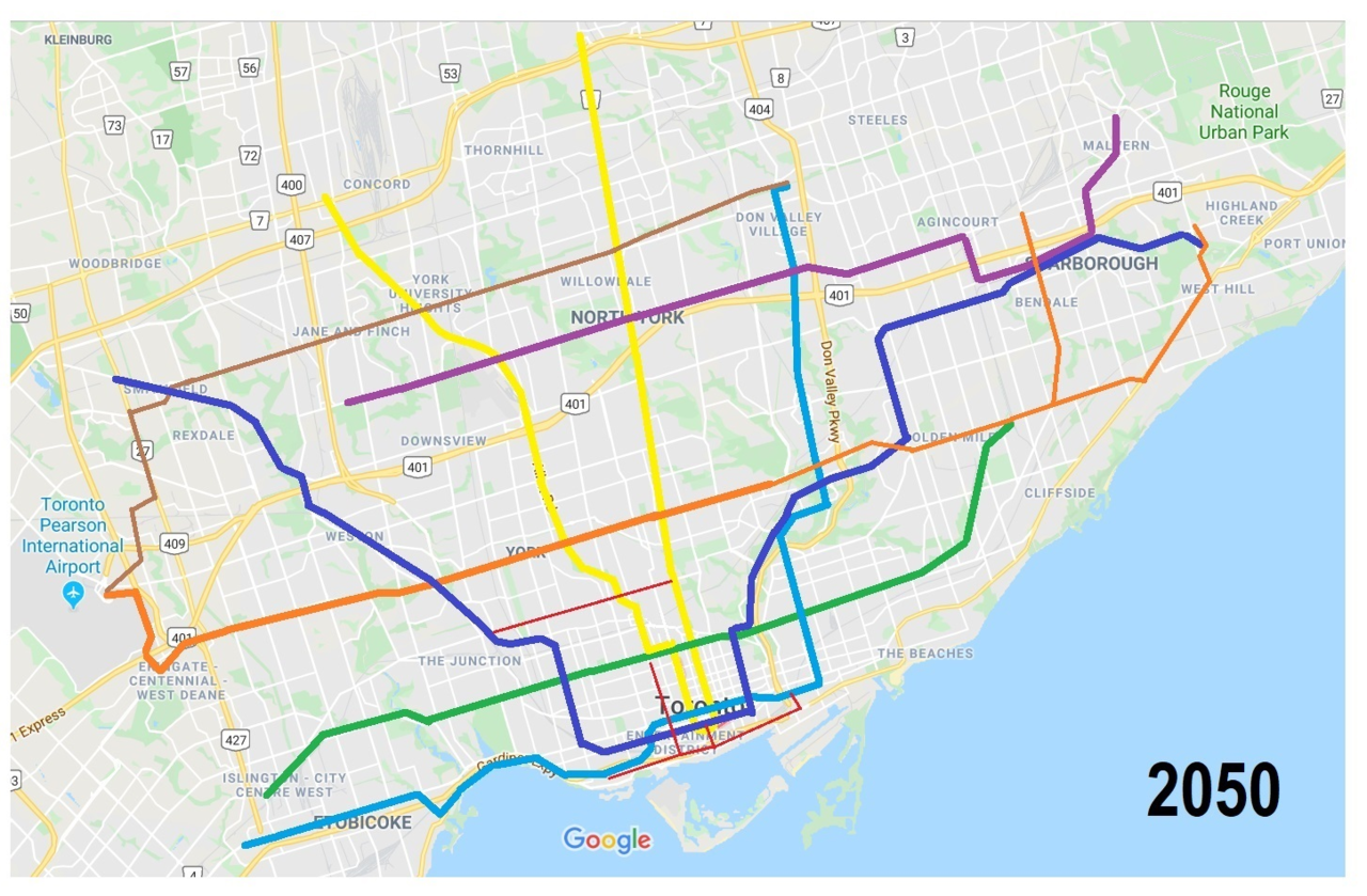

As for the map on the previous page, I had proposed something very similar a while back, only that it would be the Relief Line (back when it was still a TTC Subway) that would continue west to Spadina and then veer north under Spadina, connecting to the Spadina Subway at Bloor. This would de-couple the Spadina Line from the Yonge-University Line, allowing it and the Bloor-Danforth Line to operate in the original interlined configuration.
There would be an additional route that would run from Davisville (where there's a 3rd track and platform) to St Clair West along the current YUS alignment to serve people on the Spadina Line would are specifically bound for somewhere on the YUS downtown loop that isn't easily accessible from Queen.
Under the plan I describe above, the 501 Queen would run along Queen to Spadina, have a transfer platform provided to the Relief Line, then veer south on Spadina to King. It would run along King through downtown, re-joining Queen at the Don River, and resuming the current 501 alignment. This would allow the 501 to continue through operations, while still providing good connections to Relief Line stations for those wishing to transfer. Ideally, King would be made into a Transit Mall (or at least have the lane configuration improved to provide for even more priority), so the trip across downtown would still be relatively quick.
I recall your routing. I am not sure if interlining was part of it though or was it just to decouple (to prevent delays on one segment from affecting the other). Spending a Billion $$$ to decouple Spadina would be a difficult sell, especially considering that those coming down from the north (Eglinton West, Yorkdale, York U) would have worse access to downtown. If the money was spent to allow all people on Yonge or Bloor-Danforth direct access to downtown - it would be a winner.
With this, wouldn't it preclude the interlining?
Your above reasoning is why I was hoping to go south somewhere between the "U" (Elizabeth/York), instead of down Spadina. This would serve Spadina riders arguably better than they have now.
During construction, re-routing the Queen streetcar may be required - but once complete, why not just keep it as-is, mixed in traffic, but with lower ridership due to the subway underneath.
To avoid disruption during construction, perhaps an alignment along Richmond would be preferable - it's only 100m from Queen, would cause less disruption during construction, including less disruption to the Queen streetcar.

Other transit lines into the downtown are also definitely warranted, and I have a couple added to my fantasy map - but their discussion likely belongs on another thread. Improved GO is also needed, but again, it's a different thread.

Toronto needs more separate lines downtown..So, an idea I would respect is adding a U along Spadina and Bay and having Bloor follow that. Now Bloor riders have a 1 seat ride downtown with no need to transfer at Yonge - Bloor.
I can't picture this suggestion.
As you see, it adds stations without loosing stations.
