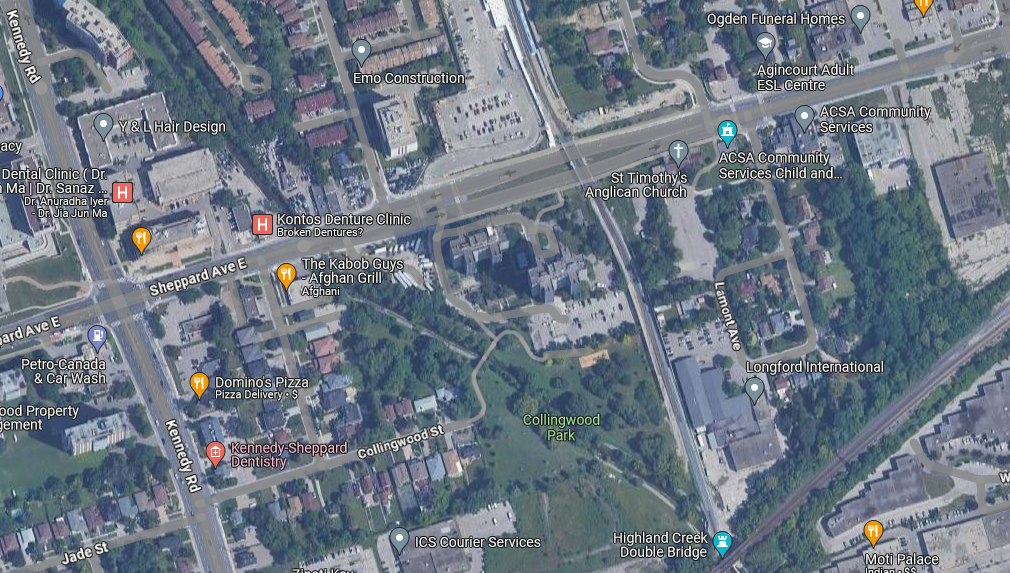

I don't believe so....... let me show you why:
In the above, lets assume your subway/metro is approaching from the west towards the Stouffville Line
Notice that immediately east of Kennedy is Highland Creek. If you are going under the GO Line you do not have room available to get down to the right grade for a push box, post-Highland Creek.
If you're going under Highland Creek, you're not going under cut-and-cover. I mean, in theory, its not utterly impossible, but you would have to coffer dam the creek and divert the flow........in practice, I don't see that happening.
Additionally, assuming you're continuing east in the Sheppard Corridor, you have the CP mainline only ~600M to the east.
Going up and then coming down again in a very short span is an issue.
Its not inconceivable to go elevated through the entire section, but because of the creek and the 2 railways, you have to stay constantly elevated, at a height that allows for double-stack freight/GO and catenary underneath, The challenge of doing that, and finding room for a station, and feathering that into a connection to the existing GO Station as well..........
I just think going under is the less complex and costly route, in that section.

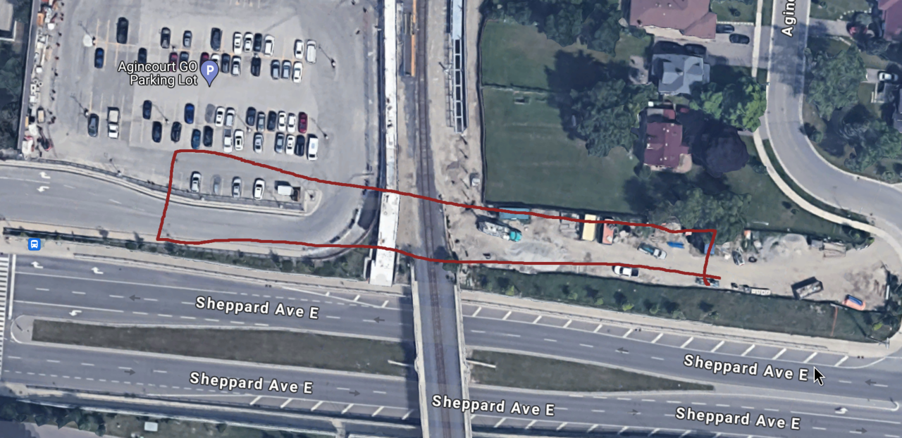

Looking at it though, I don't see what the issue would be with just elevating it on the north side of Sheppard, running above the road that connects the parking lot to Sheppard, say build the station hereish:
You'd be able to integrate the station with the planned access to the existing Agincourt platforms, and offer fairly convenient platform to platform transfers.

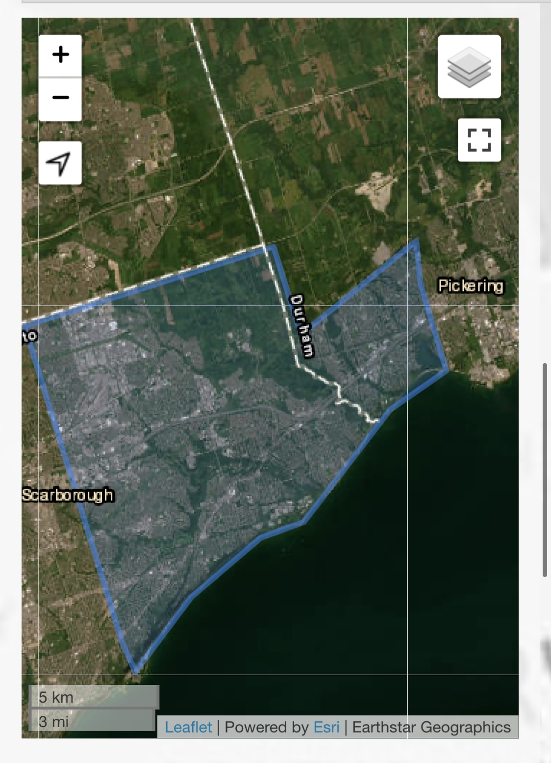

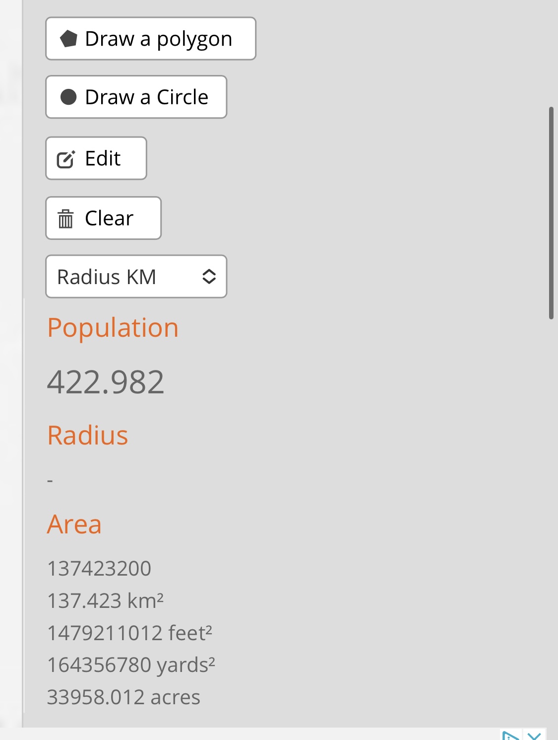

There is basically nothing in between Scarborough Town Centre and Pickering, except for the zoo, which is served by a bus connecting Rouge Hill GO. And anyone who wants to go to STC or to points further west would be far better served by taking the several bus lines that already run from Pickering to STC.
equating the homes and workplaces of hundreds of thousands to ‘basically nothing except for the zoo’ is pretty rude and ignorant
I dont think a subway needs to go to pickering anytime soon but faster transit connections to areas other than downtown are desperately needed in east scarborough and all over the GTA
I live in east scarborough and dont have a car,
I often dont even bother applying to jobs in north york, durham, or markham because they take me 30mins-1hour longer to get too than downtown despite being closer
