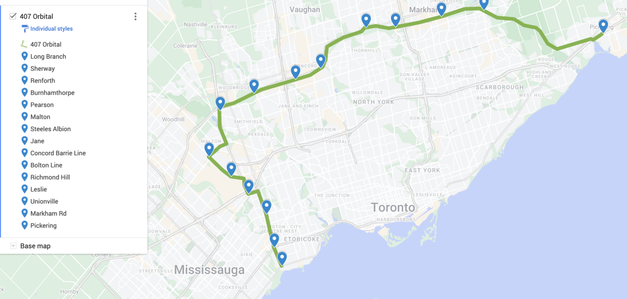

I think that an orbital line would be better located along the 427/407 corridors (and is probably being planned along there). Would hit more development nodes (Vaughan, Richmond Hill, Markham, and Pickering), intersect with all GO Lines + Yonge University twice.
this works too of course. this would be similar to the Suburban Rail Loop plan in Melbourne I guess, but where would it intersect with Line 4?
do you envision this line to be a new GO line, a light metro or LRT?
I don't think it intersects with Line 4. Which is fine, the orbital Line doesn't have to intersect with every line.
It would probably be some kind of Light Metro in my opinion, but owned and operated by Metrolinx. There's no benefit for a low-floor train b/c we're running this in its own ROW most of the time, and a heavy GO bilevel train is overkill / cumbersome for the kind of ducking and weaving this line will have to do to avoid the highways and overpasses.
Conversion to LRT seems like a non-starter.
Politically maybe, but I think the case could be made in terms of connectivity with the Finch West LRT at the west end at the Eglinton East LRT at the east end.
