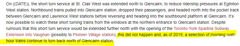

It was a practice that (while I cannot find schedules, apparently) was already done by the TTC.
Of course, the larger issue is afternoon peak hour trains, but those could be turned at Sheppard West.
(Total number of trains to TYSSE in afternoon rush = 120, people taking those trains: less than 40,000.)
