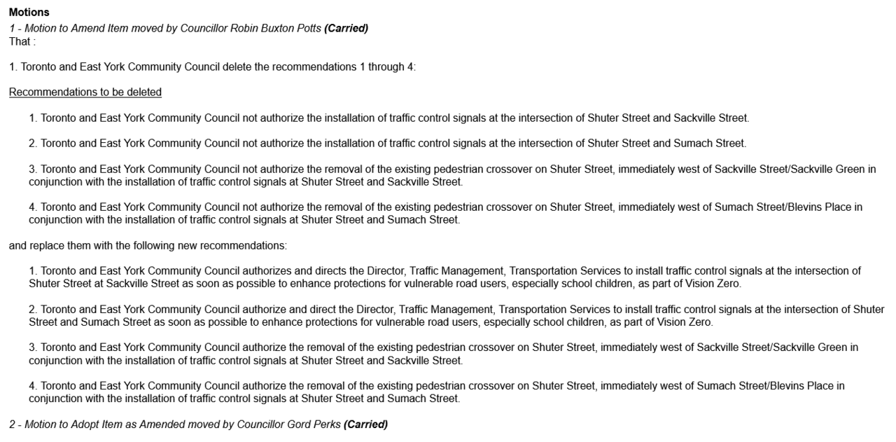

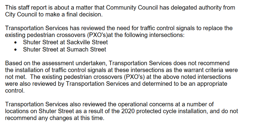

I am happy to throw the signal group of Transportation under the bus..........
However, they're off the hook here.
Have a look at what last year's report said:
It was the interim Councillor who imposed these with this motion:
This is usually how it goes. I often look up the approval process when I see a signal go in in a completely stupid place, and usually Transportation Services recommended that the signal not be installed but Community Council voted to overrule them and install it anway. From what I've seen, the staff in the signals operations group, District traffic operations groups and TTC operations group are all opposed to the ridiculous overproliferation of signals in illogical places, though the District often faces political pressure to adjust their recommendations to reduce opposition to the proposed unwarranted signal.
