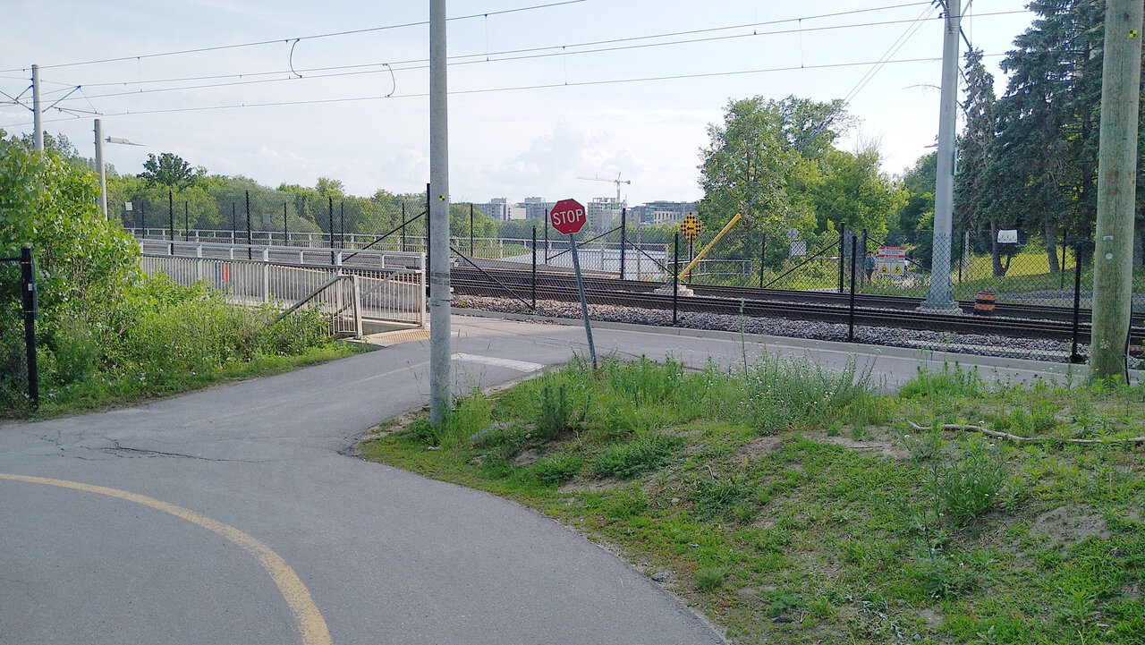

If we legalized rolling through stop signs it would eliminate the interest in changing stupid traffic controls at places like this:
Stop sign at the intersection of two bike paths were the side street is uphill and all bikes need to slow anyway to turn.
There are a few locations along bike routes which genuinely do require a stop sign due to visibility restrictions, and eliminating the meaning of a stop sign would eliminate the most suitable form of traffic control for the situation. The only safe control then would be a traffic signal, which is even worse than a stop sign.
