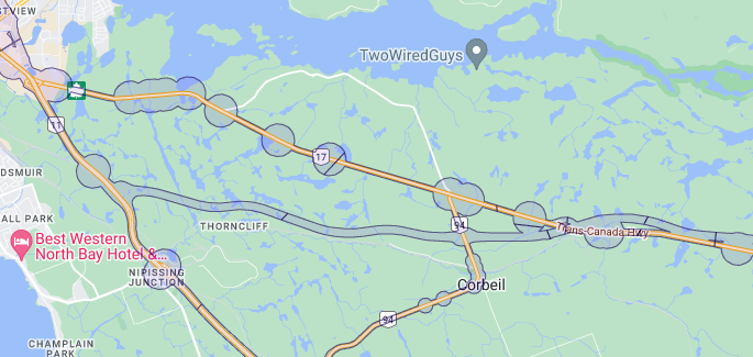

You can also see where 17 will eventually travel east of North Bay once it's (at some point) upgraded to a full freeway:

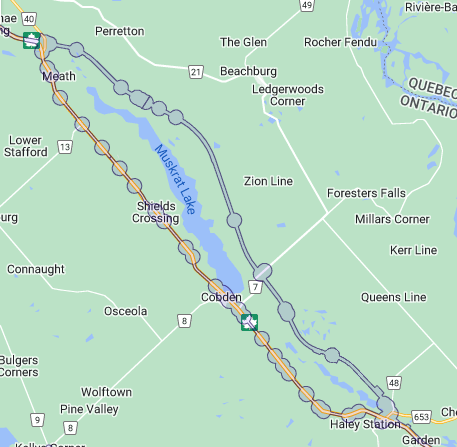

How the 417 once extended to Petawawa will go around the east side of Muskrat Lake:

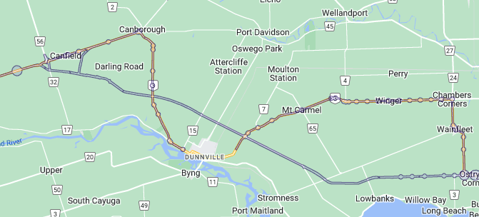

The eventual realignment of Hwy 3 around Dunnville:
