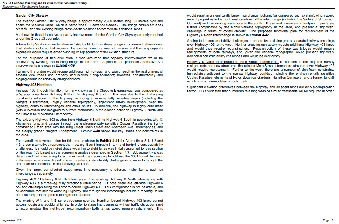

The report itself says that the intent is for it to be a 12-lane structure (2 additional lanes in each direction) like I suggested, but they drew it with 16 to "allow for long term expansion and construction staging in the future", apparently.
Regarding the 403 through Hamilton - The very same study looked at that as well:

The same report also reviewed at a high level widening the 403 through Aldershot, the Freeman interchange, the 403/QEW interchange in Oakville, upgrading the RHVP / QEW interchange, and twinning the Garden City Skyway. several of these have since proceeded to full EAs and are even advancing to construction (Garden City Skyway twinning), including the 403/QEW Oakville interchange, Freeman Interchange, and 403 through Aldershot.
you can see all the long term lane widenings MTO has planned on this graphic - I will note that the 403 through Aldershot has since been changed to an additional general purpose lane, not a HOV.

believe it or not MTO has background plans to allow for the widening of the Burlington Skyway - it's not an immovable object, especially since they are doing the Garden City Skyway already.. Not sure why you are proposing a 10-lane cross section across the Garden City Skyway but only an 8-lane cross-section on the Burlington Skyway. It would be expensive, but given the traffic over it I could see it happening at some point.
I just figured since they recently finished rehabbing it that they wouldn't be touching it for a pretty long time. The Garden City Skyway on the other hand has been mentioned for replacement.

Extremely tricky given the grades involved. It would likely involve either a pretty substantial rock cut or building some kind of double decker structure to add lanes. And then there would be widening through the Chedoke Creek section.
