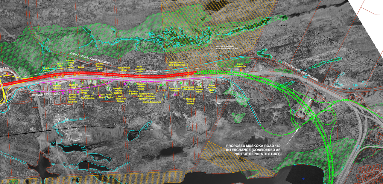

I have the PDF for the Washago-Gravenhurst section..
This gives you an idea of the design:
Total section:

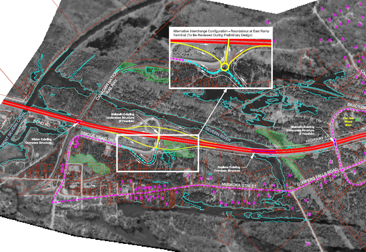

Hwy 169 Interchange in Washago:
This EA was done about a decade ago and was available online at the time, I believe the section south of Washago was done a while ago (late 90's or early 2000's) and wasn't available online at all.
The West St interchange in Orillia is getting replaced right now, and the preliminary design for it showed a 6-lane cross section of Hwy 11 as well.

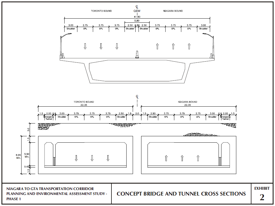

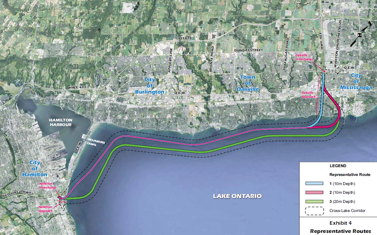

going down my saved highway designs from MTO rabbit hole.. I will still forever love how MTO somewhat-seriously considered a cross-Lake-Ontario tunnel to Bypass Halton Region as an actual option at one point, going as far as to design preliminary interchanges:
Total section:
Well, if nothing else, it looks like they plan to remediate the tight curve at 169/Gravenhurst. The s/b Tim's would have to close. Such is the price of progress.
