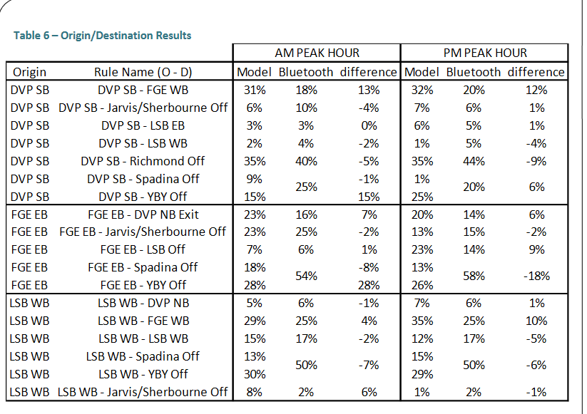

@Northern Light isn't wrong, at least based on 2010 data:
Richmond ramp handled 40% of DVP southbound volume.
The Gardiner/DVP is basically a highway analogue of the YUS. Anyways, I think the Gardiner East (Phase 1 of the overall plan) is worth $300M.
Refer to p. 17.
18% of SB traffic on the DVP goes to the WB Gardiner in the AM Peak. (through traffic)
35% exits at one of DT off-ramps
40% exits at Richmond.
In PM peak, only 14% of traffic from Gardiner EB flows to the DVP.
That is statistically insignificant and easily absorbable by LSB.

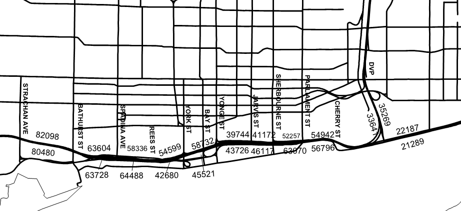

You've both been intentionally misled by groups like Waterfront Toronto when they use Origin/Destination statistics. Refer to my attachment (Insert B) to grasp just how much traffic the DVP and Gardiner carry in the average day.
The Gardiner (12 years ago) carries over 80,000 vehicles per direction (160,000 total) west of Bathurst. So while 14% of SB DVP traffic carries through the Gardiner west of Downtown, many more hop on the Gardiner on-ramps in that stretch. 14% + 10% + 25% = 49% take the DVP to Gardiner WB ramp, which is what people wanted to convert to a Boulevard.
In PM peak, 14% of Gardiner EB flows to DVP. But wait a minute, this section has over 110,000 vehicles per day. Waterfront Toronto conveniently ignores all traffic using the Gardiner EB on-ramps downtown when trying to justify its removal.
The busiest sections of Lake Shore Boulevard can only accommodate about 40,000 vehicles per day and they are at capacity.
I haven't been mislead by anyone.
I know exactly what I'm reading, thank you.
The discussion here was not about turning the Gardiner at Bay Street into a boulevard.
The discussion was about turning the Gardiner at points east of Jarvis into a boulevard.
Nothing you stated changes the traffic volumes I indicated over the applicable section.
Lakeshore blvd is NOT at capacity in the applicable section either.
