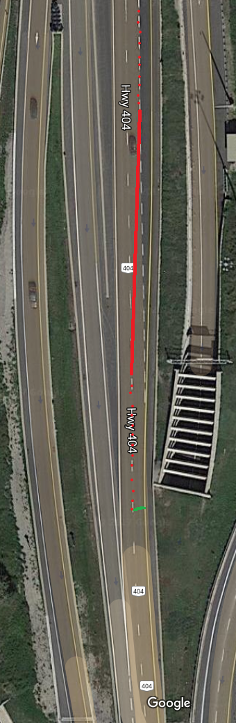

Edit: whipped up a crummy MS Paint mockup of what I mean:
The red dots represent bollards (having started all the way up at Finch) and the red line represents either a concrete barrier or very tightly spaced bollards. The horizontal green line at the south end represents where it stops being an HOV lane and lane changes are allowed.

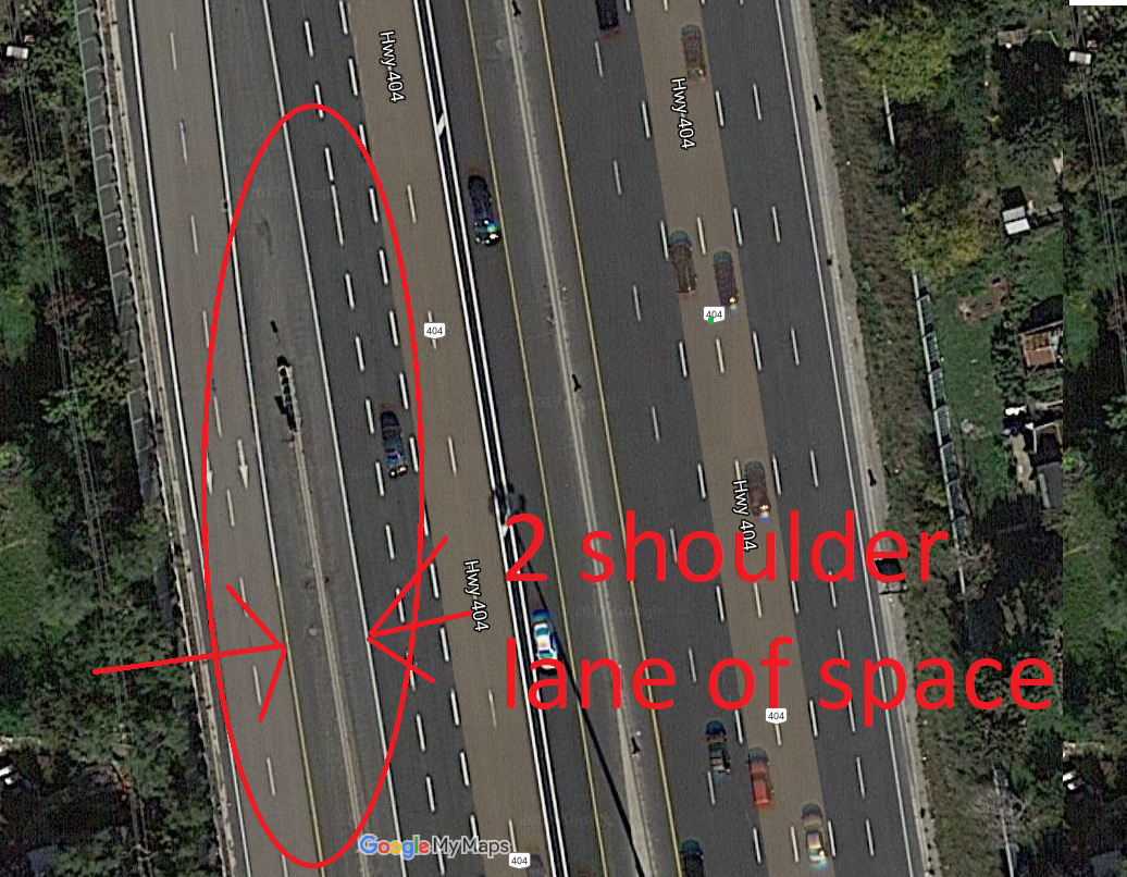

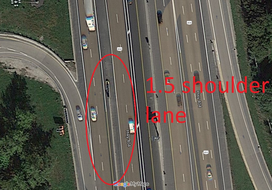

That's just an invitation for someone to drift off lane and end up dead within a few hours bollards are installed. They wouldn't last a week without proper shoulder lanes. The design is terrible for 80+ km/h. There need to widen the roadway by 2 shoulder lanes (at least 6-8m) to actually install any sort of divider. You'll see any single lane exit lanes still have shoulder space.
I agree HOV lanes are dangerous without physical separation. Research has shown that. It would cost millions more to widen the area that MTO doesn't want to spend money on as it doesn't benefit them politically.
