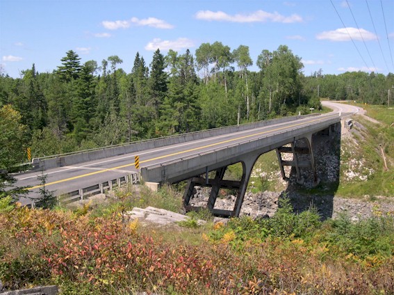

The channel being kept clear of obstacles is not a navigation requirement. Navigation requires a specific opening size depending on the waterway. For the French, it is likely a 20' high clearance requirement (6m) by maybe 1/3 of the channel width (about 20m). They are staying out of the water for 3 possible requirements.
  1. First Nation requirement.
  2. Fisheries or other Aquatic wildlife concerns.
  3. Constructability due to construction of piers in deep water.
For this crossing, it is likely all of the above. The choice of structure type is interesting. There are only 2 other such inclined leg rigid frame bridges in Ontario - Seine River and South Muskoka River., and both are significantly shorter than the French (and Pickeral) crossings.

Cable-stayed bridge can be ruled out then.
