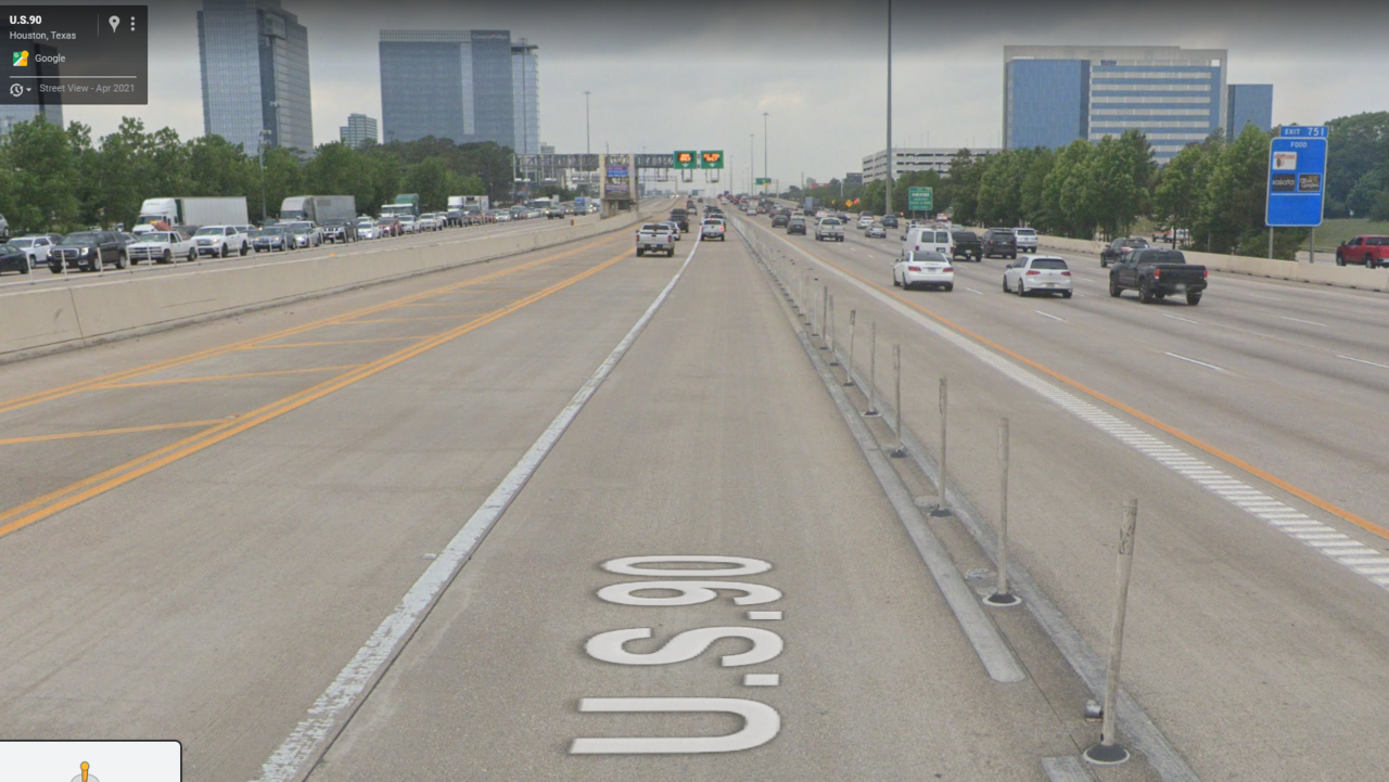

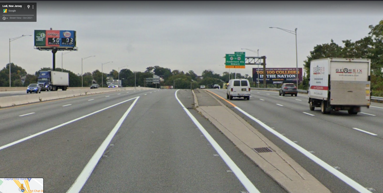

Well in other areas of the world they have small markers in the buffer zones, or even a concrete slab similar to island medians for larger roads
I bet Toronto mad lads would drive over that.
