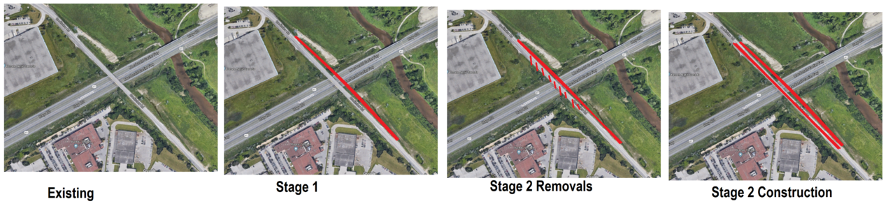

Actually based on the plans I have seen, the intent is to maintain traffic on existing Creditview while the new bridge is built in two stages (hence the slight realignment). In other words, the east half of the new bridge is built first, then traffic moves onto it and then the existing bridge is demolished and new bridge completed. There is also a very significant grade raise for the new bridge which should be interesting to observe how the new roadway approaches are constructed next to the existing road.
So this would be different than the McLaughlin Road over 401 replacement, where the road was completely closed for a year.
However, if the Designer/Contractor can succeed in arguing it is too difficult to maintain traffic on Creditview while building the new bridge then it is possible Creditview over 401 may be closed for a year.
Not much different what I already have said. Not sure what you mean by east bridge as its either north or south since 401 is basely e-w. If you are saying the existing Creditview bridge is being shifted to the east, that's a fair shift and allows the road to be open, depending on the shift. If that the case, the road will be close like I have said to allow the express lanes bridge to be built. Regardless one way or another the road will be close up to a year or so to fully build the new road.
I'm not sure what's actually happening. What is described above is build new bridge east of existing. flip traffic to new bridge. demolish existing bridge. build new west half of bridge. What the two half bridges are tied together or left with a 50mm gap depends on their width. Likely if 2 lane bridges then tied together. If 3 lanes or wide multi use path, then separate. :
