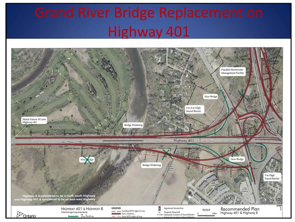

Most has been deferred.
The 2 major 8 to 401 ramps are deferred. Only the Grand River Bridge will be replaced and widened.
