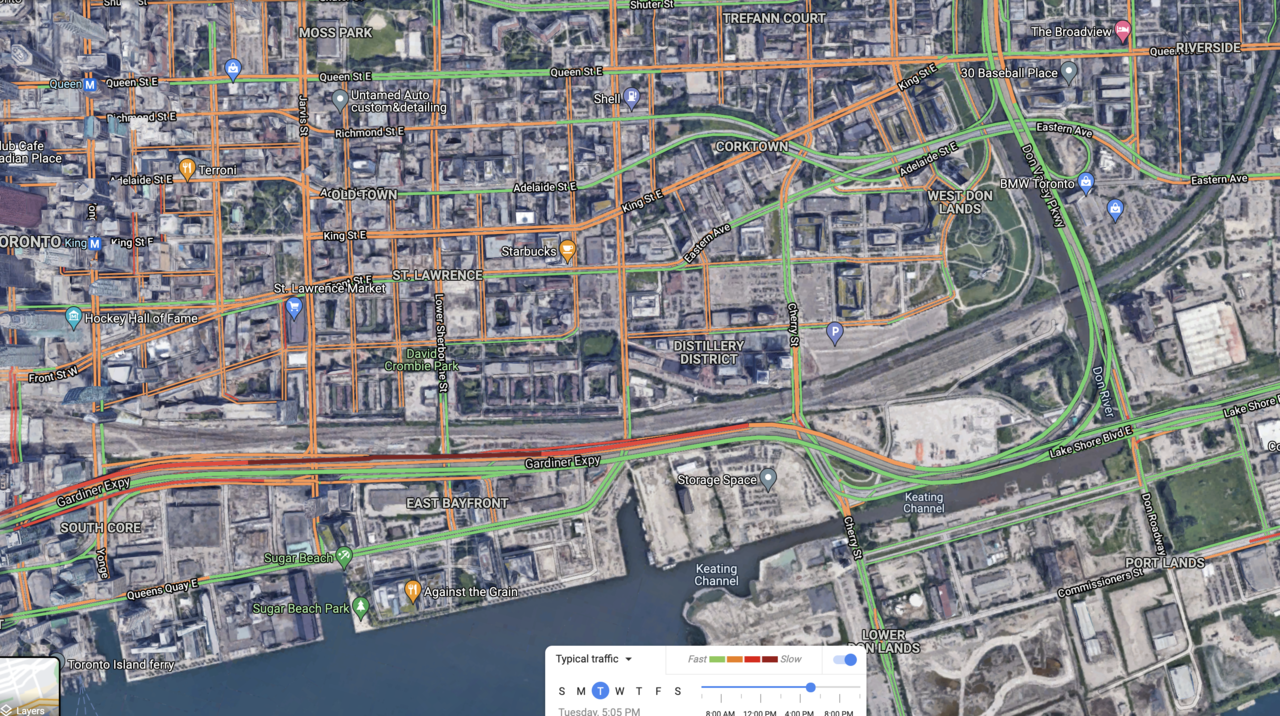

Most of the traffic exits off at Bayview/Bloor and at Richmond. This is the reason the Gardner between DVP and Jarvis is extremely empty with 100km/h speeds even during peak traffic. The number of cars definitely does not justify the ramps between DVP and Gardiner.
Hmmm.... that's just not my experience at all.
The SB DVP always jams up as it ramps on to the Gardiner in the morning rush hour and even in the evening rush hour the Gardiner often jams up all the way back to the DVP and is quite busy.

I agree that EB on the Gardiner once you pass Jarvis is pretty sparse (so good to tear down the Logan ramp) but I think the majority of the SB DVP traffic ramps on to the Gardiner WB rather than exists at Richmond.
But maybe my perception is all wrong. Weird though, because I drive it every day.

According to studies Waterfront Toronto has done, southbound DVP traffic are heading to Yonge/Spadina with some going west part way and the remainder going beyond 427,
If the Gardiner came down to Yonge, the DVP traffic would use the Lake Shore and get back on the Gardiner at Yonge to carry on west.
