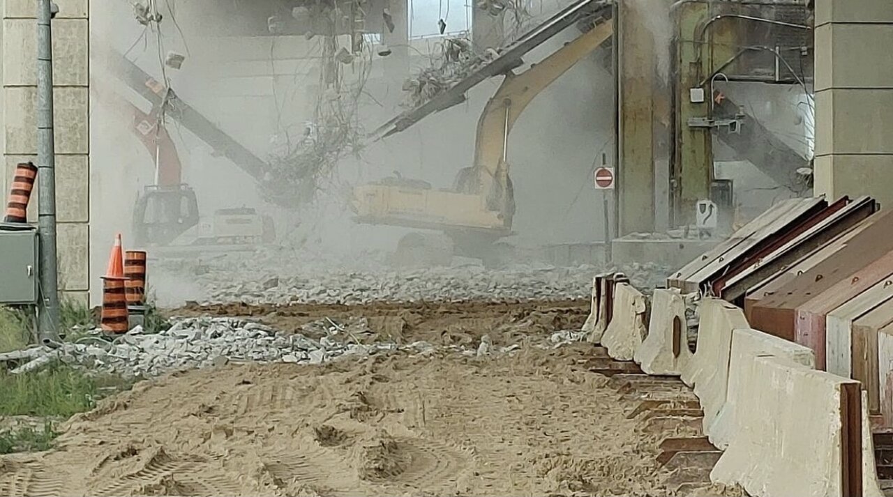

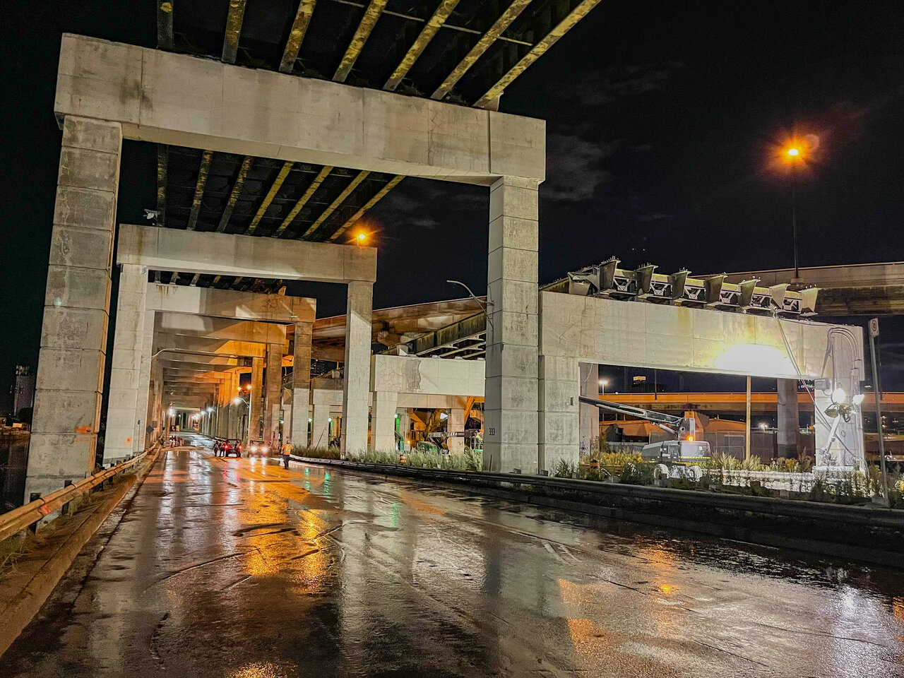

A little late but I took these last Tuesday & Wednesday evening.
The existing pillars on the east are more than enough (I assume those are staying)
It maybe great to try to retain a bent or 2, but how do you get 6 lanes of traffic through them when it was built for 4 lanes??
Every thing has to come down west of the Don Ways as that whole area will be redevelop as well widening of the mouth of the Don.
You can leave a post only with a short section at the top as a reminder of past days, but that must happen now before they are gone.

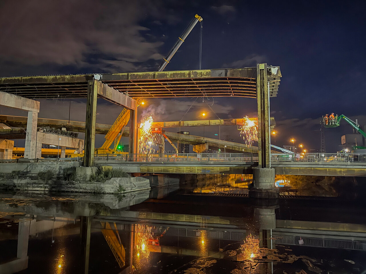

Any idea if they are tearing down all the way back to bent 329? I'm curious how cleanly the Gardiner will be cut back to the DVP ramp. I can't wait to go down there when this is done and see the sky from the north shore of the Keating Channel.
Amazing photos! Wow.
Question, what do you use to cut through the huge steel sections? Is it always just a plasma cutter, or would you ever use a thermic lance? What would be the benefits/drawback of each?
We used Thermal Lances on this one over the Plasma for portability and to keep torchman at a better distance while in the baskets also thermal lances seen to work better for on site when thick steel with many angles are involved. On these mass cutting jobs sparks do happen to get into respirators and do smoulder. Even with being a few more feet back with the lances it does happen but we’ve found less than plasma.
When's the next major demolition planned? Is it only weekends? And then clean up for Monday morning each time?
Correct, demolition is limited to weekends. Total project timeline is 5 weekends before penalties.
PDI is aiming for a fully finished project by 4 weekends. So 3 weekends of demolition left.
Tear down of machines and haul out isn’t calculated into actual project time, so you may still see the odd machine in the staging areas as we are also working on earthworks across the road too.
